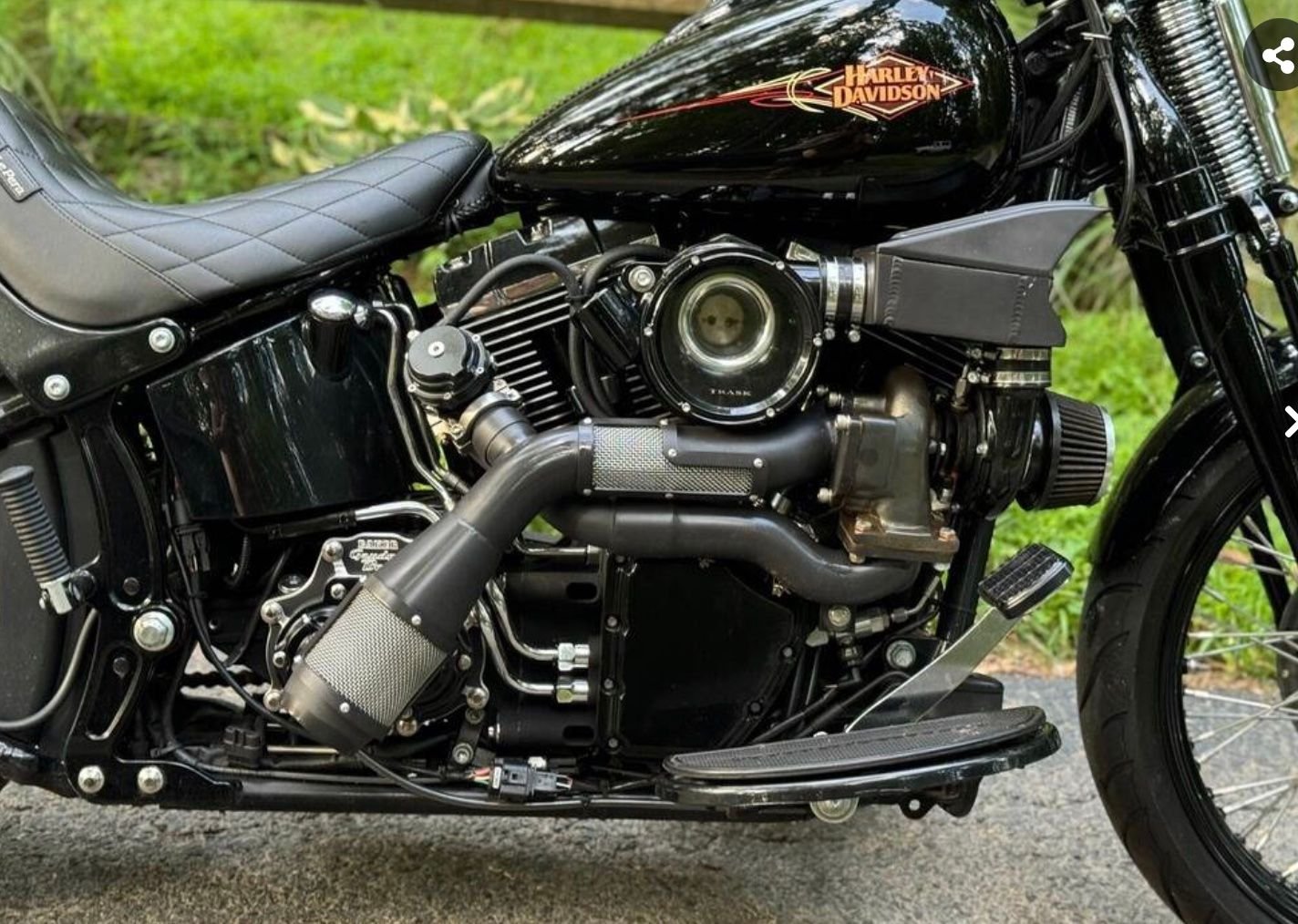

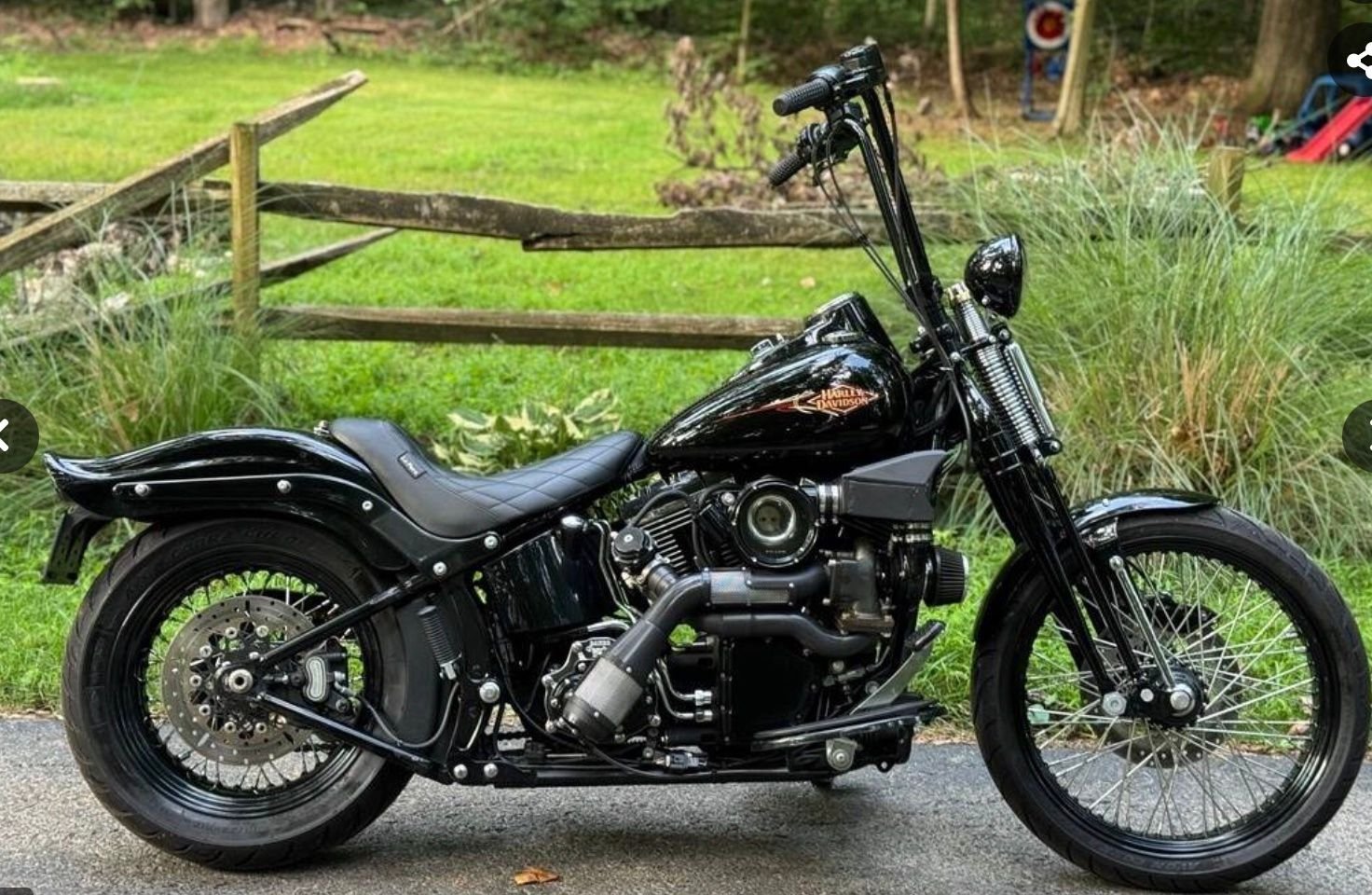

I saw this Springer on the internet... This owner wasn't hesitant... I have to admit, I'd have to change bars, but I'd love to take this one for a spin...
