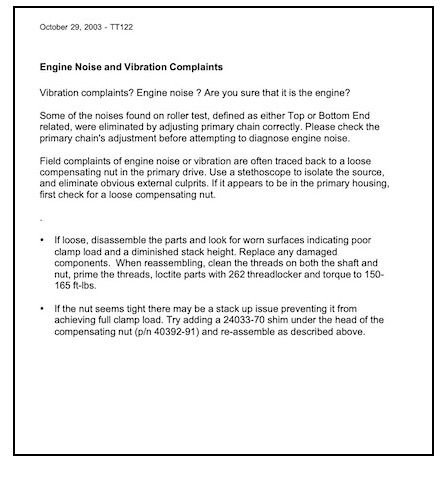

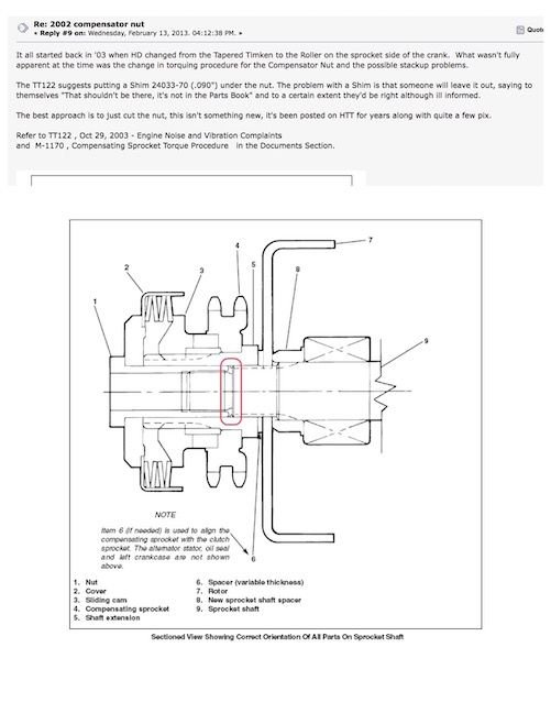

Originally Posted by heritagefan
Hello, I just bought a 2005 Heritage and it lasted me 2 weeks before it is sitting broke down an hour from my house. Researched the issue and I think it's stemming from a bad compensator. Any advice?
I've read your other thread...
Is your research via internet searches, or have you opened up the primary and inspected the components....?
The pre-2006 Dynas, and pre-2007 all other model's compensator was a pretty bullet proof design. It had few issues, even when pushed to its limits.
It did have one issue. The comp bolt coming loose and or not providing full clamp load when properly torqued. That issue was addressed in HD Tech Tip 122 "Engine Noise and Vibration Complaints", Service Bulletin M-1170 "Compensating Sprocket Torque Procedure", and on tech sites
I hope this information helps with your diagnosis...
