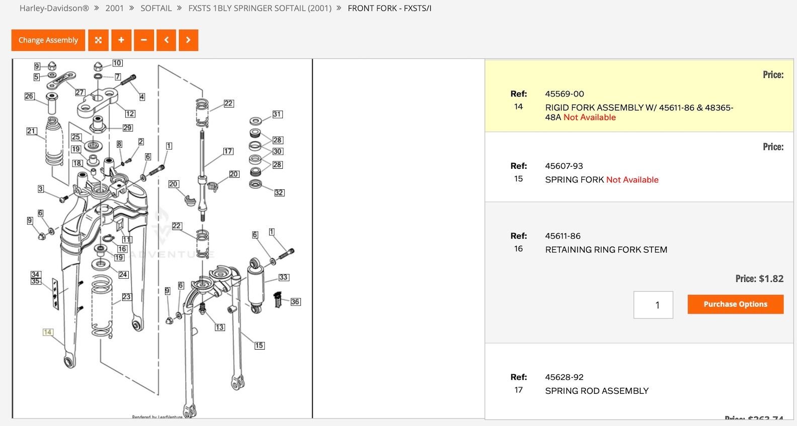

Originally Posted by Ron Pinette
I have a bent springer rear section. It is bent below the tree. Can the lower legs be removed from the tree?
The rear legs (rigid fork assembly)...No
The front legs (spring fork)... Yes
You didn't mention the year or model, but here is an exploded diagram of a a 2001 FXSTS Springer front end. They are all pretty similar but with differences like the side the caliper mounts on.
