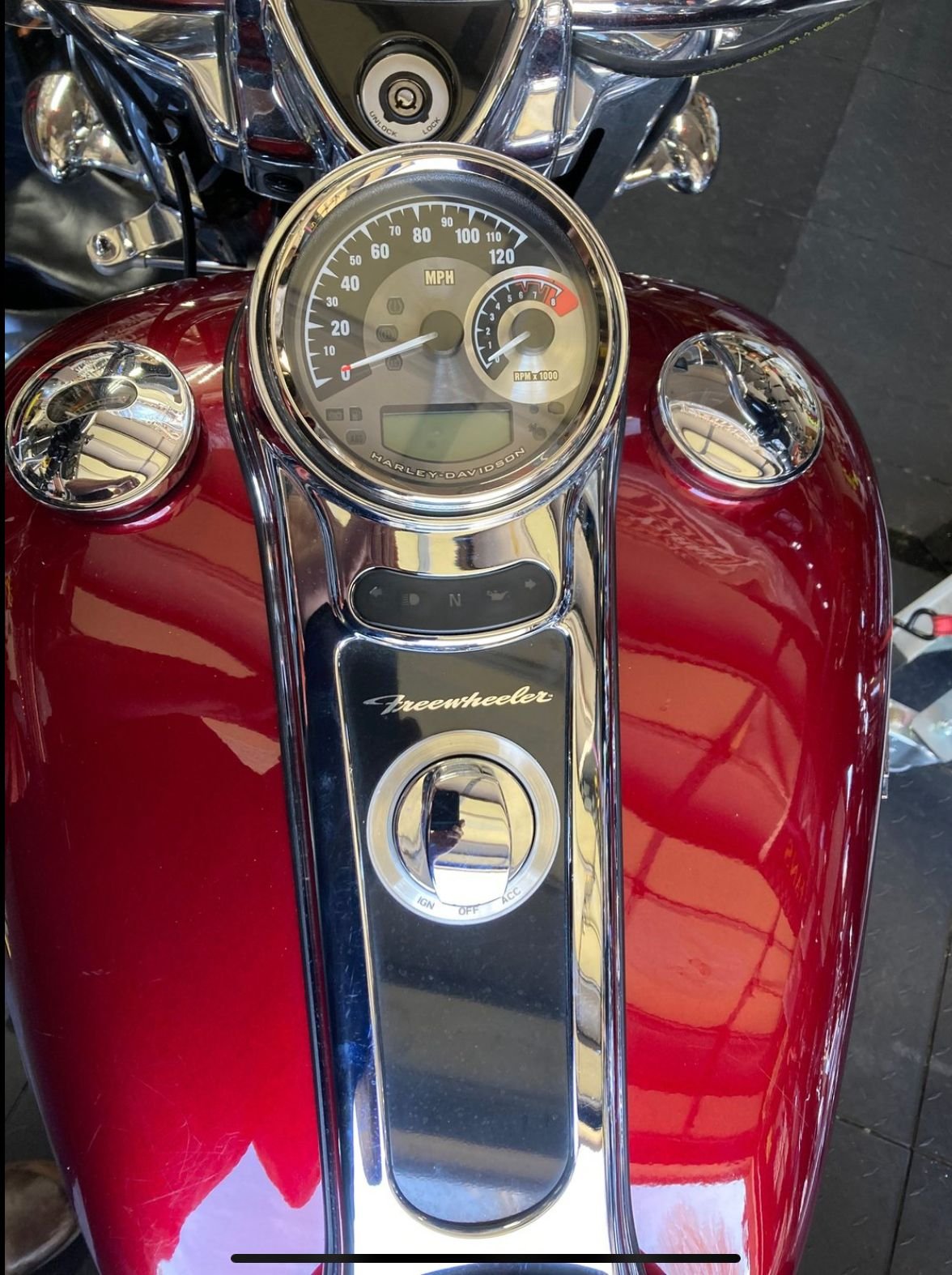

Originally Posted by skyflyer
the HD website is not always accurate It might fit but I doubt most of the options would work.
Skyflyer is correct.
Per the Harley website there is no speedo/tach compatible with the Freewheeler.

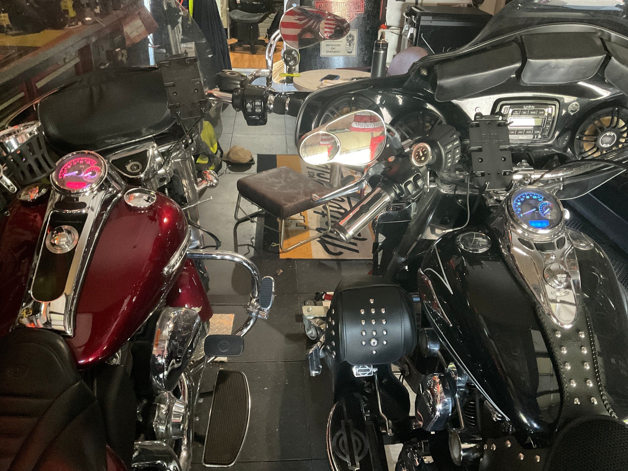

Below is a picture of a Harley speedo/tach installed on my Freewheeler.
Also is a bonus side-by-side picture of the Harley speedo/tach also on my Heritage.
