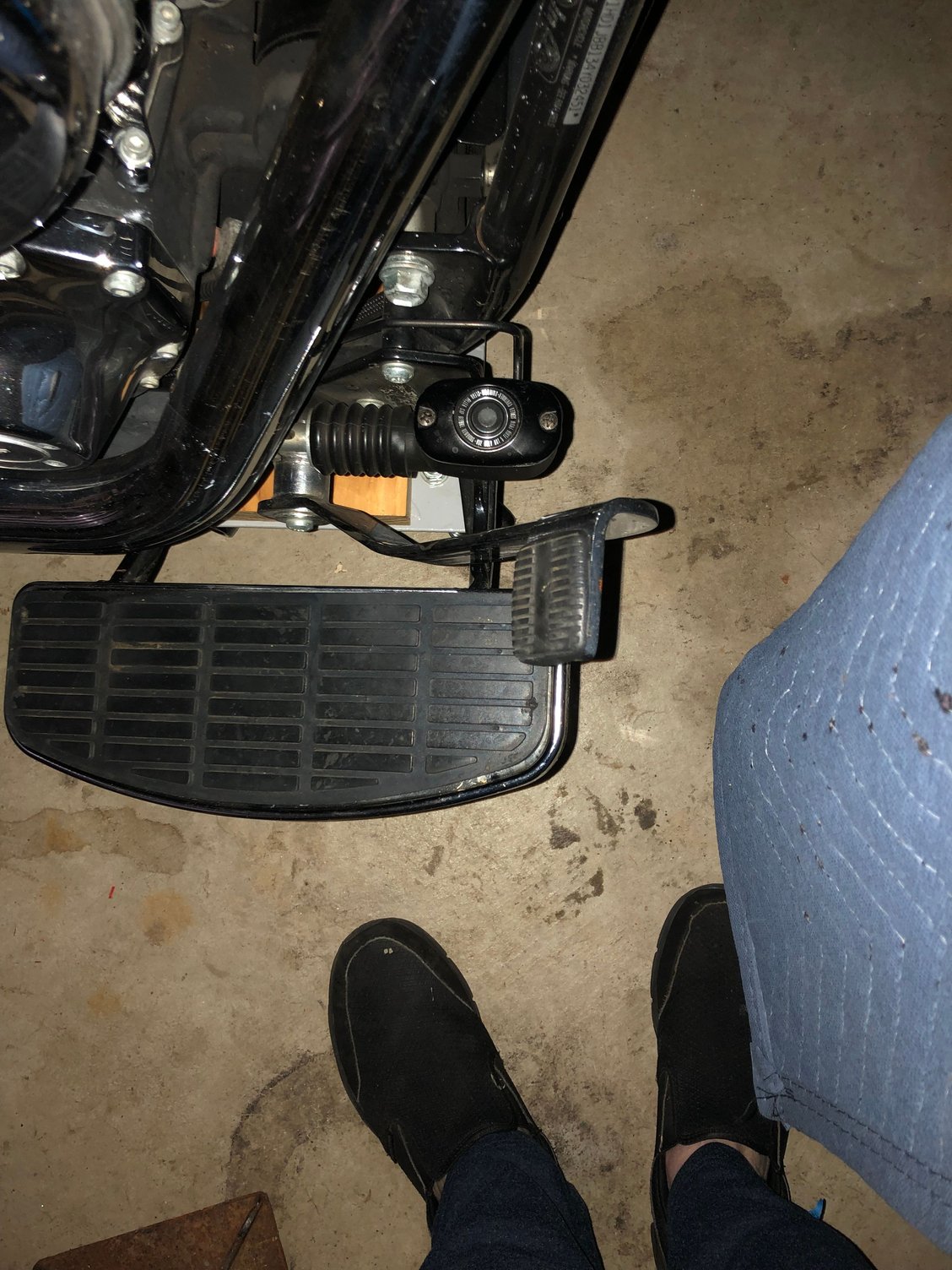

Keep in mind that to do the swap you will need to change the inner primary and I'm not sure if they ever made one for a softail that has the pass through for the shifter setup.. They do however make reduced reach brackets to bring your forwards closer to you.. I had to do it on the 2013 dyna.. night and day difference.. I'm only 5'7"..

as mentioned, you need to change the primary covers too
Easiest route?
Put floor boards on it and it will make a world of difference
(did for me)
simple bolt on swap utilizing Fatboy floorboard mounts (2000-'06)
Nothing else to change but the mounts .
Then hang floorboards on it
KTF

I take it, you guys didn't look at the kit.. The kit gets around changing the inner primary.. It might take some work on the brake side tho. I like the floor board idea. OP can also get a seat that moves *** forward.
Thanks! I'll be looking into this option as they aren't giving away the mid control kits.
A few inches would make a big diff..... another post suggests floorboards and it's also
easier on the cash flo. Appreciate the ideas

Thanks for the feedback1 I'll post my solution when I decide which way to go...
Still haven't found a photo of a Deuce with mid controls anywhere on the www

Did you see Max’s post #7? I clicked the link and that kit looks like it has a way around changing the primary cover.
