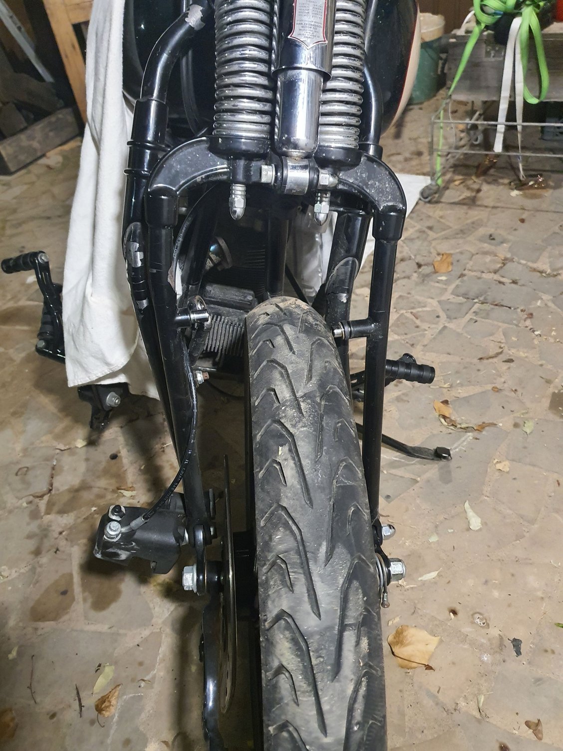

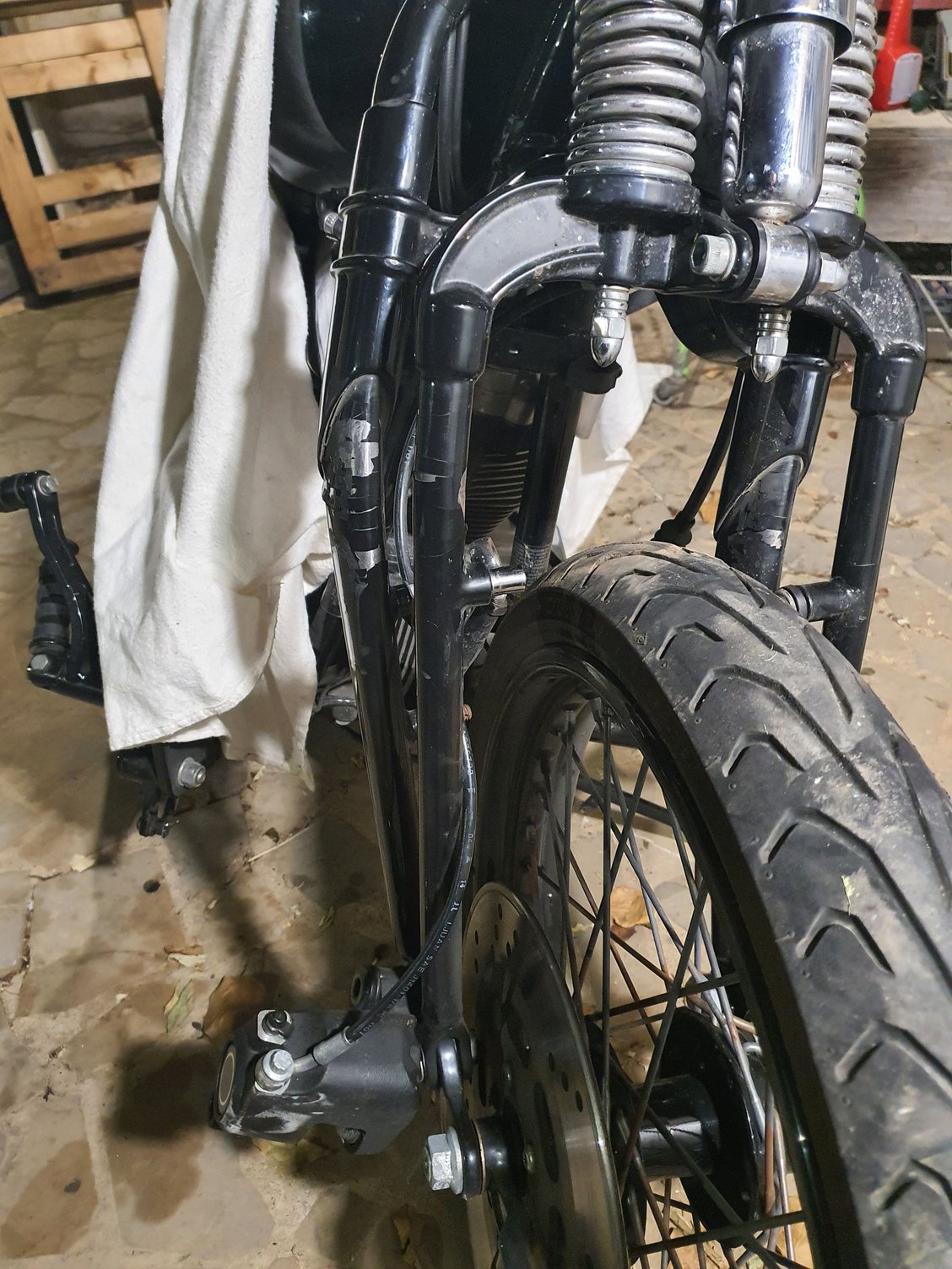

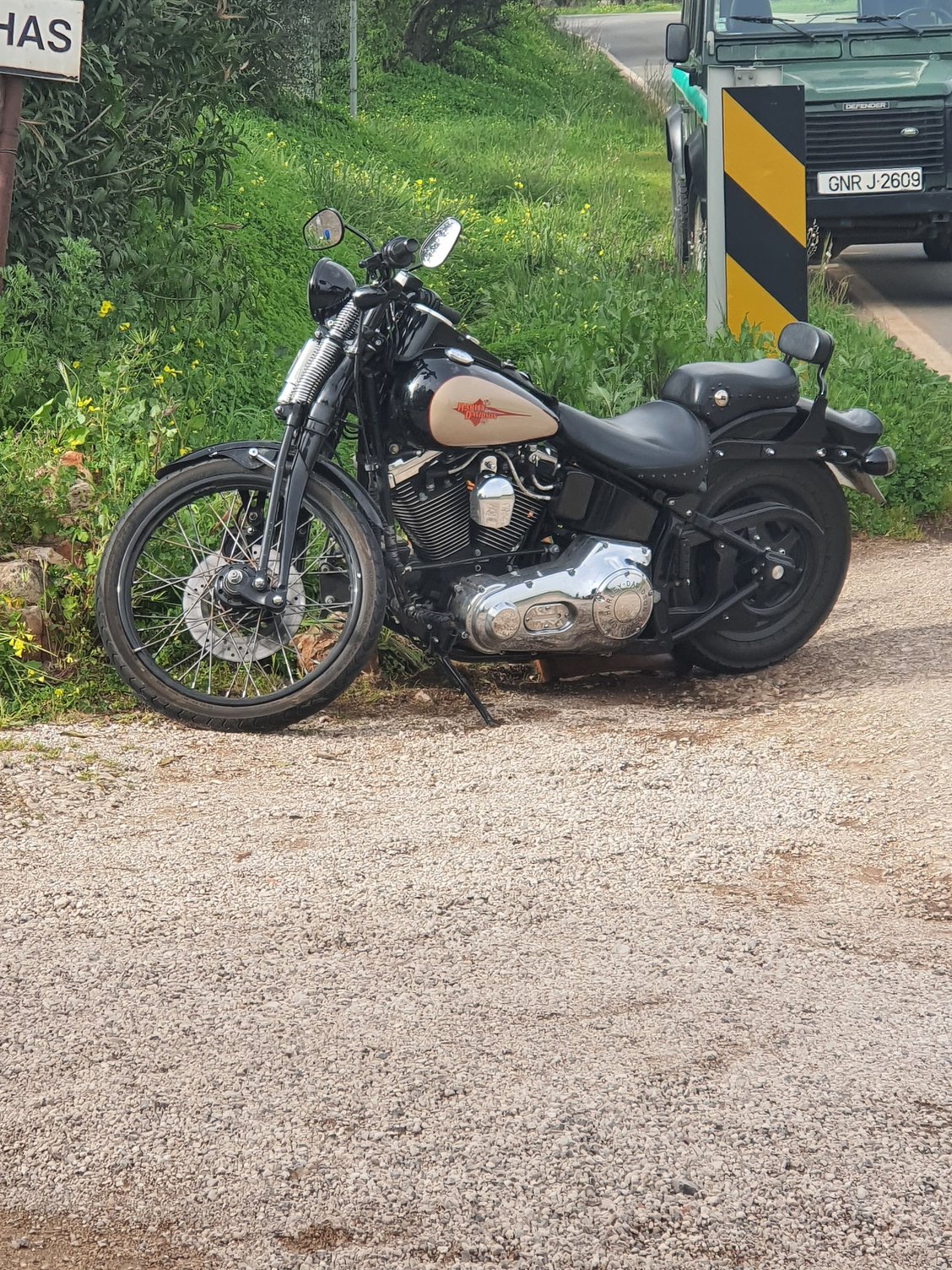

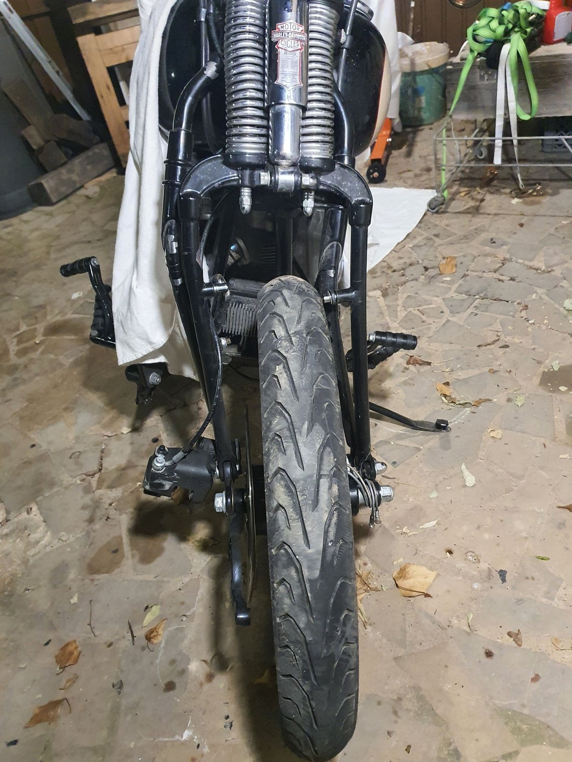

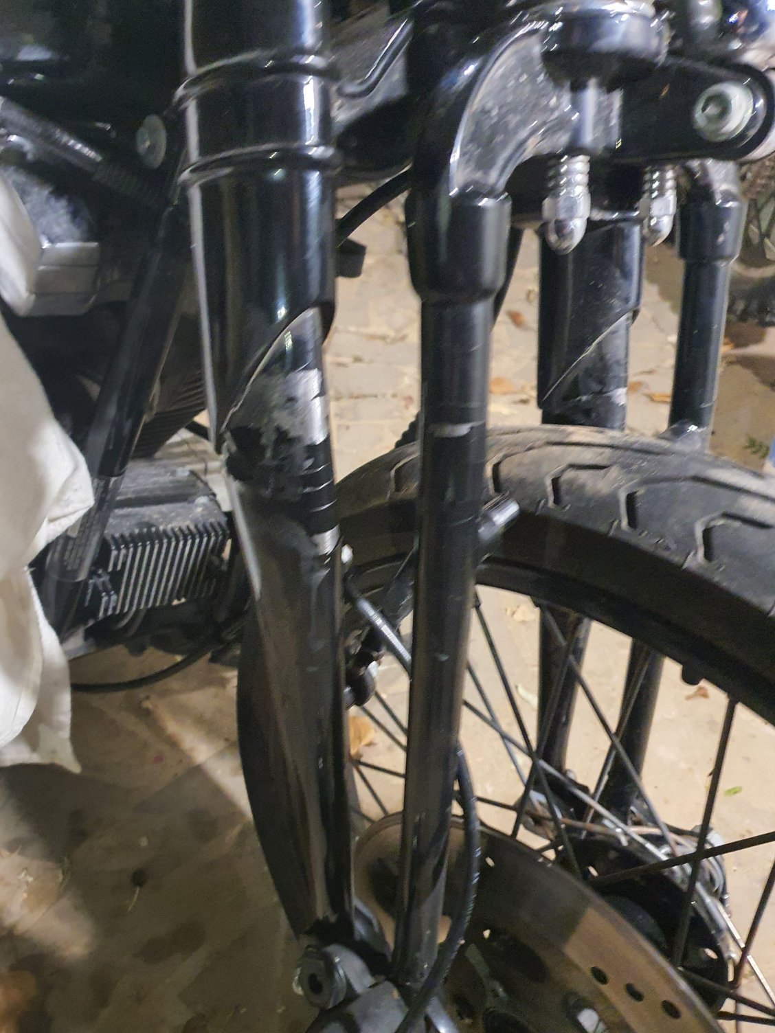

In March I got cutoff and destroyed the front end on my 1997 springer , now I got the payout and the bike and wanted to just put a regular softail conventional forks .
I see lots of posts going from conventional to springer on various bikes but not Springer to conventional , my question is what should I be looking for in terms of used front ends ?
Thanks in advance
Jason

Without seeing the r/s fork, those sure do look straighten-able to me!
I don't think so ....I posted pics

Your springer FLSTS shares the same frame as FLSTC ( 16" fat tire) and FXST ( 21" skinny tire)
So, it boils down to the look you want and what is available "over there"

Interesting topic!
I would venture to guess that this springer fork could be straightened by a specialized German workshop for a cost of perhaps 500,- Euros?
A backyard blacksmith would straighten the fork for half the price.
In the USA, this is certainly not a problem; however, here in Germany, straightened suspension components are no longer road-legal.
This means that your insurance coverage is voided—or, if you were to run someone over and kill them, you would be paying for the victim for the rest of your life, or your relatives would have to pay on your behalf...
It is also interesting to note that, beneath the black-painted fork, lies a fully chrome-plated one.
That is precisely what multiplies the difficulty of straightening this fork in any way whatsoever.
Perhaps you should hang the fork on a wall as a memento—straightening it out to ride on it again, or even selling it after it’s been repaired, could end up costing you dearly.
