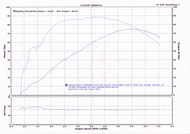

These are mine on the 2008 fatBoy shown in my signature.
Screamin Eagle heavy Breather
V & H Big radius 2 - 2
PC III With Custom Map 100
