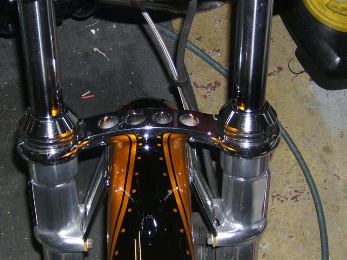

I found this one in a add in a motorcycle mag a few years ago.......about 150 bucks if i remember right........i like the look,i haven't seen many like it on the road
Attached Thumbnails Fork brace options-brace-ii.jpg   Fork brace options-braceiii.jpg

I like that look and can't seem to find one that will fit a rocker..any ideas 49mm

Have you though about getting a 41mm one and letting a machinist bore it out to 49mm for you?
Have to make sure the leg spacing is the same center to center, but outside of that there's no reason it couldn't be done that way.
Here's a 49mm for a wideglide front fork assemble. I know it says its for a Dyna, but they use the same tube spacing and diameter so it should fit fine.
http://www.jpcycles.com/productgroup...3-451C15B21289
