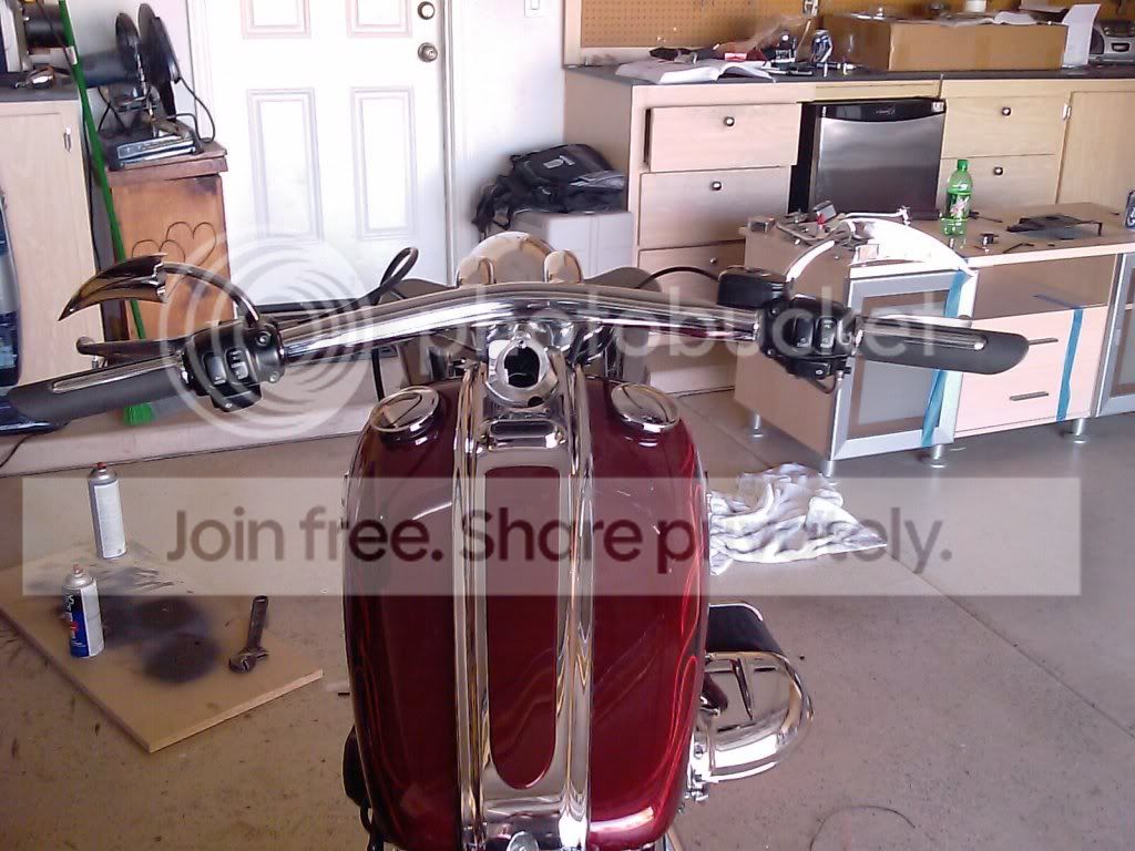

Both of you are right on! dam have to unsnap all of those wiring harness, but this is the most logical route.. I stared at it and other then going extreme thoughts the simple solutions eluded me.. Thanks To you and wallie
if you go that route make sure to use a higher grade strength bolt
5 or better sometimes we/I think to much and mess it up(easy solution)

Mike, Yea I was looking at grade 8 bolts for this job..

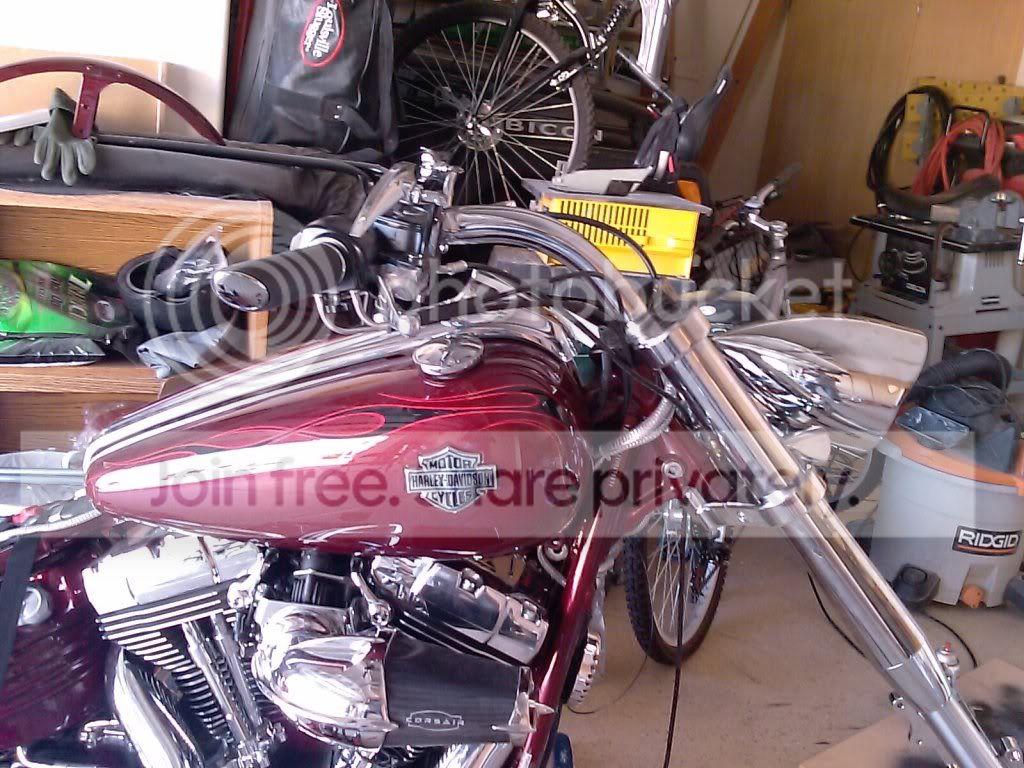

[QUOTE=tomhummer;4725218]I added this part to give my bars more heighth...they say one inch on this pic but i put 1.5" risers on mine and they worked great...that should give you the clearance you need...don't need to get rid of your bars...these go between the tree and the bottom of your bars

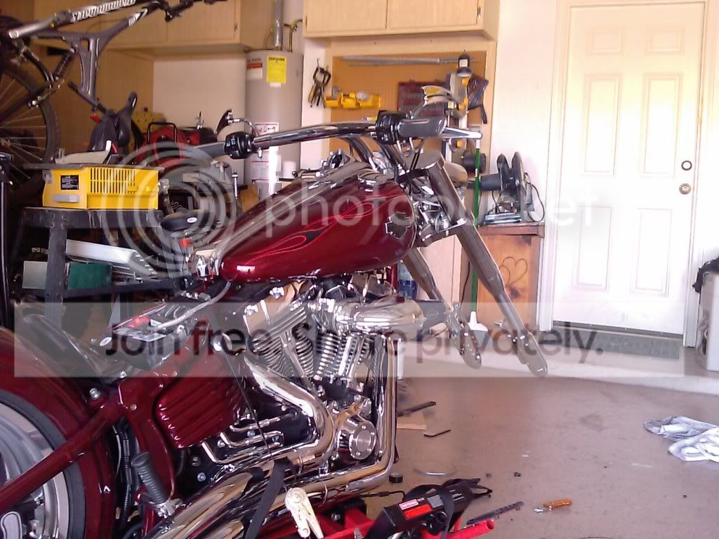

Here is the plan.. See if I can get a speedo that will fit or have one made.. I want a small one that will fit in the cavity of the huge one i just ripped out (gently removed).. This is my "right now" fix... I got it started and everything works (cross fingers)... If anyone know of any potential problems running it with out a speedo please advise...I did cover up all the exposed plugs.. All ready just waiting now on a caliper and tire...

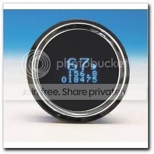

Hey Joe, want to be a guinne pig for one of my hair brained ideas? Dakota Digital makes a 2-1/16" diameter mini-speedo/tach that is only 1" deep. I was going to try removing the cup from the stock spedo and drill out the console to fit. Looks to me like there is a hole to fill but I'm sure we could come up with something.

Turbo and for all fellow rockers, this is what i have found out with help from Turbo..
Here is the right up on it..
This gauge is industry standard 2-1/16" diameter and features an outboard control module (which measures 3"x3"x1.5") that centralizes wiring for easy installation, and minimizes wire running to the gauge itself. This gauge features a non-glare, high-brightness, vacuum fluorescent graphic display with no engraved annunciators for a black out effect when off.
The HLY-3015 is packed with features including a 199 MPH speedo, user selectable 0-5000, 0-8000 or 0-16,000 RPM bar graph tach, menu driven set up and calibration, odometer/trip, plus indicators for turn signals, high-beam, neutral, low oil pressure and check engine for fuel injected models.
User selectable screens allow the rider to display speed only, speed with odometer and trip, or speed with bar graph tach.
The HLY-3015 has many mounting options: flush mounted into a tank, bar mounted into a cup or bracket, the possibilities are endless. 2-1/6" diameter cutout, 2-3/16" overall diameter, 1-1/2" deep
Ok I found it at phat performance for about 425.00 not to include the cup if need one.. I cant order it until I seel some of my parts or until next month.. If anyone knows of a place that would be cheaper HOLLER...
