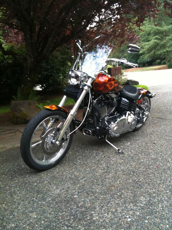

OK, this post is about windshields on a Rocker. I know, I know, it's like **** on a bull, why buy a Rocker if you want a windshield, yadda, yadda, yadda (can anyone tell I read all the Rocker windshield threads recently?).
But anyway, I only have one bike right now and I want to take some longer freeway rides. I like to wear a half helmet and I don't really like bugs and rocks in my face at 75 mph. So I want a windshield that I clip on for long rides, and maybe take off when I get where I'm going to do some cruising.
I read a lot of mixed reviews of the two HD windshield options and couldn't really find any good pics, so I decided to experiment.
I'll start off by saying that my bike has a 2" tank lift and a Danny Gray Solo seat, both of which affect the aerodynamics. I'm 6' 1" tall and with the Danny Gray I probably sit 2-3" lower than the stock seat. So if anything my results below are probably best-case.
First I tried the "low profile" version (HD 57253-08). I have to say that it *looked* a hell of a lot better than I expected. It's more of a sport fairing than a windshield really. But when I road tested it, it was absolutely terrible. I got buffeting on the shoulders and chest at low-to-medium speeds (where without the windshield I had no wind pressure at all). At freeway speeds the buffeting moved right up to my face, about chin to forehead. It was much worse than the normal pressure you feel at that speed with no windshield. And I got the strong feeling that any rocks or bugs that would have gotten me in the chest before would be heading right to my face. So that was pretty much a failure in every way.
I took it back to the shop and they were happy to trade me for the standard-height version (HD 57251-08). This one surprisingly didn't look as bad as I thought it would either. On the road test I'd say it was about the same as no windshield at low-to-medium speeds. On the freeway it behaved similar to the low profile version, but moved the buffeting up to the forehead area. You could still definitely feel it, probably about comparable to the pressure with no windshield. But no wind at all hit my body, and I felt like things coming at me would probably be going mostly over the top of my helmet instead of in my face.
I will say that I didn't notice any handling problems with either windshield, which was a concern because I'd read that in a magazine review and one online post. I'm not sure that I like the tall windshield, but I'm going to keep it for now, put some miles on it, and see how I like it over time. I'll report back in a month or two.
But the short windshield, I honestly have no idea what that could be for. Maybe if you wore a full face and wanted to keep the wind and debris off of your chest, but it will definitely not shield your face, and if anything will throw more wind and debris at it. And if you're on a stock seat it would be even worse. I wouldn't recommend that to anyone.
The standard height windshield might have the same problems if you are on a stock seat or if you are a taller rider. In my case I think it's kind of working.
And yeah, they're a little ugly, but as the parts guy said "that's why they're detachable".
Anyway, hope that helps anyone thinking about windshields on a rocker.
Pics of both windshields attached.
