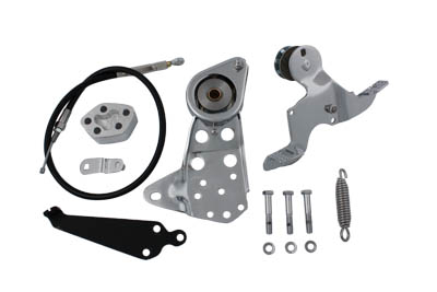

No, it's the Heel Toe Clutch.... Cable driven.. That mouse trap was like a clutch assist that was frame mounted when Hand clutches were introduced.
HEre is what I have.

I'm easily confused....
so with your set up you can hit the rear pedal and take your foot off the pedal and the clutch is dis-engaged?
or should I just have another drink and forget about it ?

Nope, no drink.. Your exactly correct.. It's toe to go... Pull up to a light push the heel down and your good.. No need to find neutral every time you stop.

If your rocker clutch pedal and adapter are from V-Twin, aka Taiwan Tedd, be very careful. I had one several years ago. I had problems with it eating the clutch cable because of the angle it traveled through, and welds breaking. It tried to strand me about 40 miles from the hacienda one dark & stormy night. A weld broke, the pedal fell off, and I caught it with my foot. Had to ride clutchless to get home - interesting, but not exactly fun. When I got home and checked everything out a poor weld was the culprit. Stripping it down to repair it found several welds that had started to crack. V-Twin would not stand behind the product. Then I found out from some other guys I do business with that V-twin regularly rips off designs, has them made overseas, and undercuts the original designer's price. Won't do business with them.
