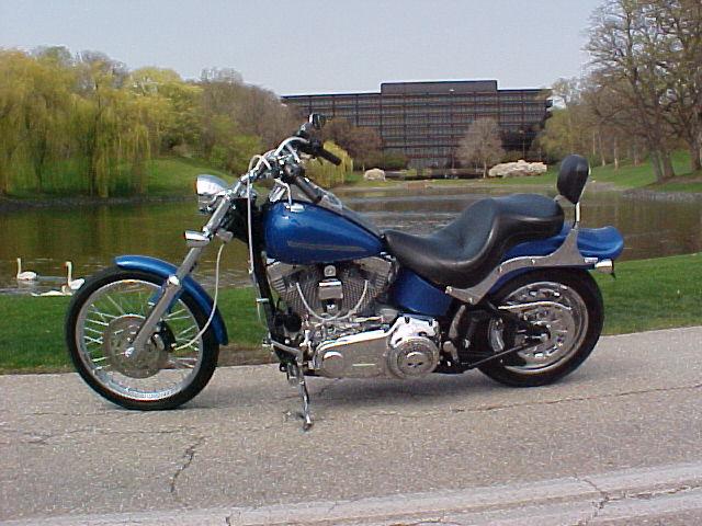

Looks like this when youre done

im doing this same mod on my xbones right now..first of all just incase DONT use a sawsall on the seat post lol ..it comes out easy if you just be patient and use lots of light ..if you choose to put in where the horn is and dont want the plug wire crossed then the coil plug needs to have the front and rear coil wires switched ..again its easy if your patient and have the manual it shows all the plugs and how to take the pins out of them..i just did mine..also if you want to use the cowbell its tight but will fit as above pic shows

or it looks like this version
Attached Thumbnails Seat post removal-mvc-230f.jpg   Seat post removal-mvc-893f.jpg   Seat post removal-mvc-880f.jpg
eitherway looks better.. the stock postion
sucked now the oil bucket is more exposed and you can see through the bike ..i like it..
