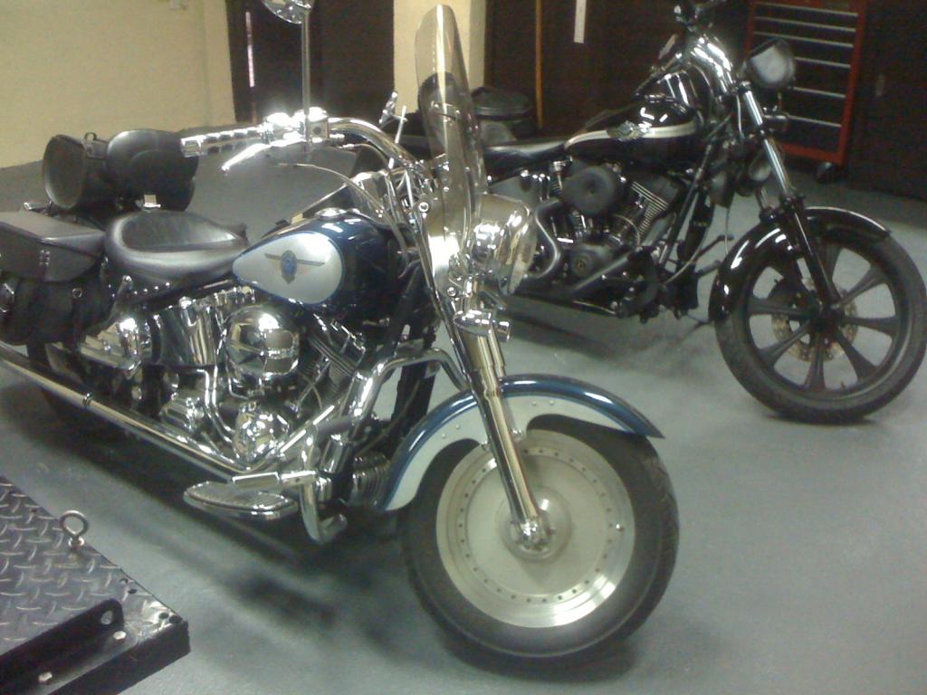

Jose,
here is a crappy cell phone picture I took when the bike was dirty lol.
