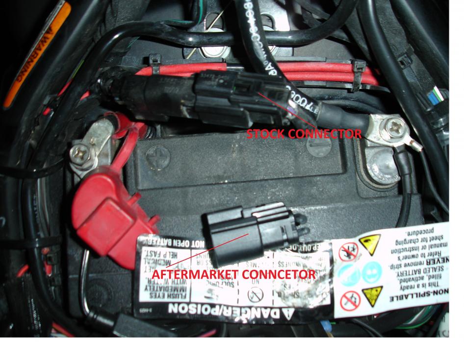

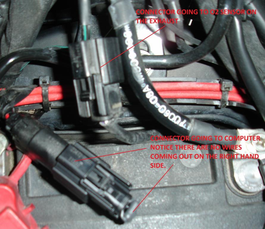

Old Aug 19, 2012 | 10:05 AM
rydnhi4x4's Avatar
rydnhi4x4
Joined: Aug 2011
Posts: 18
From: San Anontio, TX
All it is, is 2 connectors. You disconnect the the O2 sensors and put the 2 new connectors on. These connectors make the computer think that the O2 sensors are still connected in which they are really not.
The black connectors are for the rear O2 sensor which is located next to the battery as you can see. The front is a white connector under the oil filter on the bottom of the bike. Now these locations are for a 2012 Fatboy Lo just in case anyone ask.
These connectors I got free from http://electronicjetkit.com/ Maybe I got them free because these are the people I got my tuner from.
My next modification is to get rid of the O2 sensors on the exhaust by plugging them with these https://www.denniskirk.com/4405313.sku notice these are the 12mm X 1.25. I hope these will fit. I will get them on Tuesday.
Attached Thumbnails 2012 Fat Boy Lo problem code-dsc00026.jpg   2012 Fat Boy Lo problem code-dsc00028.jpg
