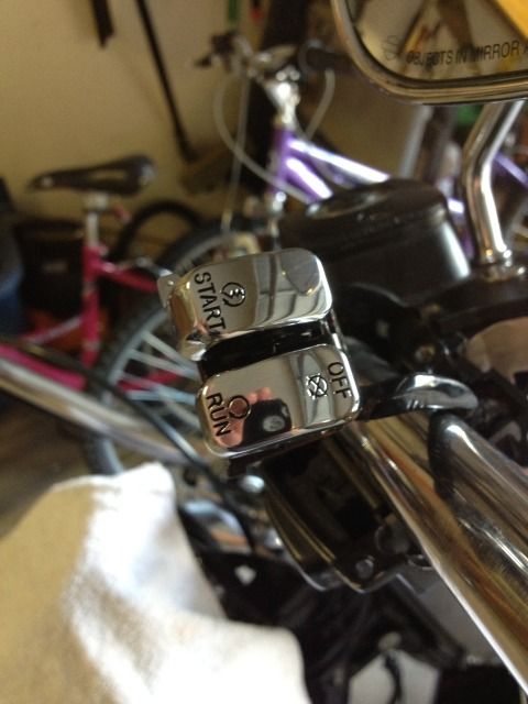

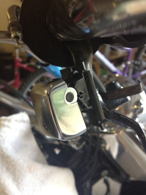

Had to Share--it took about 20-30 min(and only One Cold BEER) to do this first side and wanted to show photos of the work done. Pretty simple job but some have said it was tremendously tedious work...Just remember your orientation of the springs and your good to go
Here is another photo of Start and Run part of the Switch. I am leaving them un-assembled right now cause on Tuesday my New CHROME switch housing will be here and i can complete the whole look. Some have said hot or boiling water helped...i cant really say --i think alot of it had to do with the fact you just have to be patient and take your time and use those small tools..
