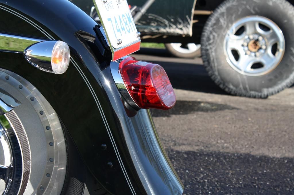

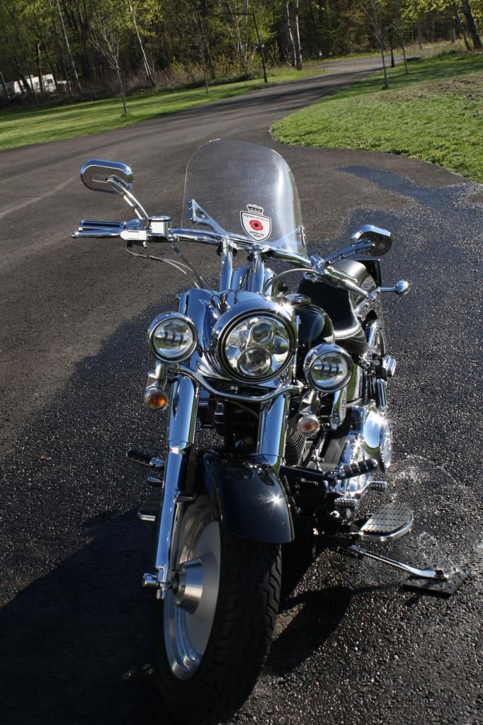

i have the leds installed and love them they increase the amount of light at least threefold you can see and be seen a lot better adding a higher level of safety to your riding experience. easy install and yes its plug and play. remember there is a lot more that goes into a light than just a bright bulb, reflector design and wire size are equally important to ensure proper luminanceonce again the old adage "you get what you pay for" was never more relevant for the rear end i have installed a brightass light that makes me more visable to approaching traffic. once again plug and play install check them out.
