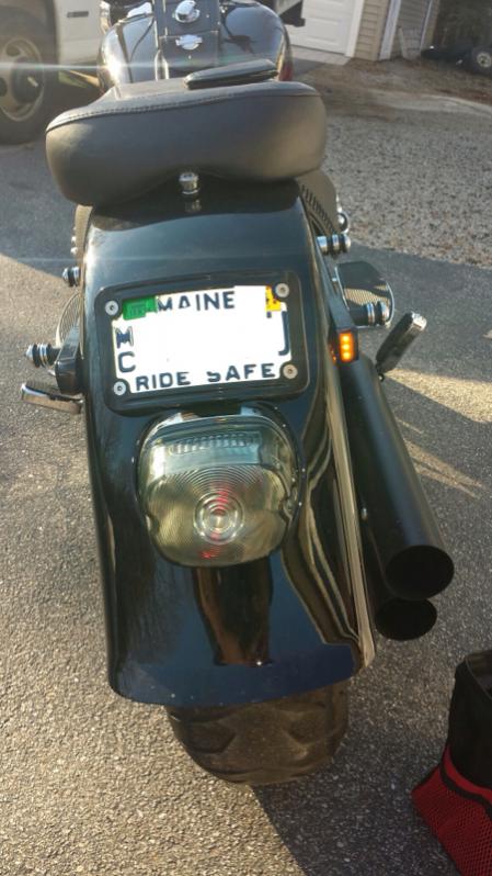

Installed Alloy Art LED front turn signals last season. No load equalizer and no rapid flash, they worked fine. I just installed rear strut LED alloy art signals, and now I have a rapid flash, which doesn't surprise me. I will get a load equalizer that should solve that issue, but my new issue is that the red key light on my instrument cluster is now lit up all the time-and I don't have a security system. I'm assuming its a dummy light telling me I have a signal light out (at least the computer thinks so due to the low LED draw), but I just want to make sure this is the case and it's not some other electrical or engine issue going on. Anyone else have this issue when installing LED's? And will the load equalizer solve this problem? Either way here are a few pics of them installed. I had the housings powder coated and I'm super impressed with the quality overall.

Not to change the subject or hi-Jack your thread but those 3 little red lights your stop lights in the picture on the right?

The little lights are amber and those are the signals. The brake lamp is a red incandescent bulb with the smoked lens.
