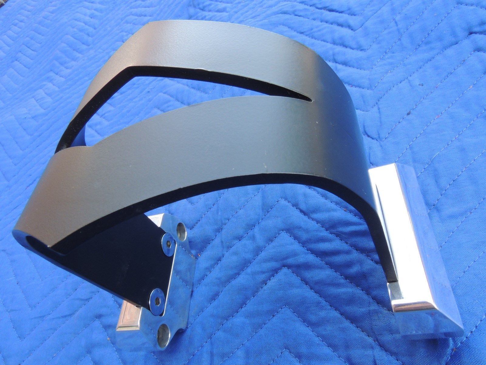

Nice job steven725 looks good bro. i was thinking something similar
, i finally just found one someone custom made its on order so Im hoping it fits! Not sure with the machined mounts, though he said he was running 23 with it. If not ima chop an RSD too.

seems to me like those lower polished mounts could be styled as a universal fit. Be good for Alain's ride.
