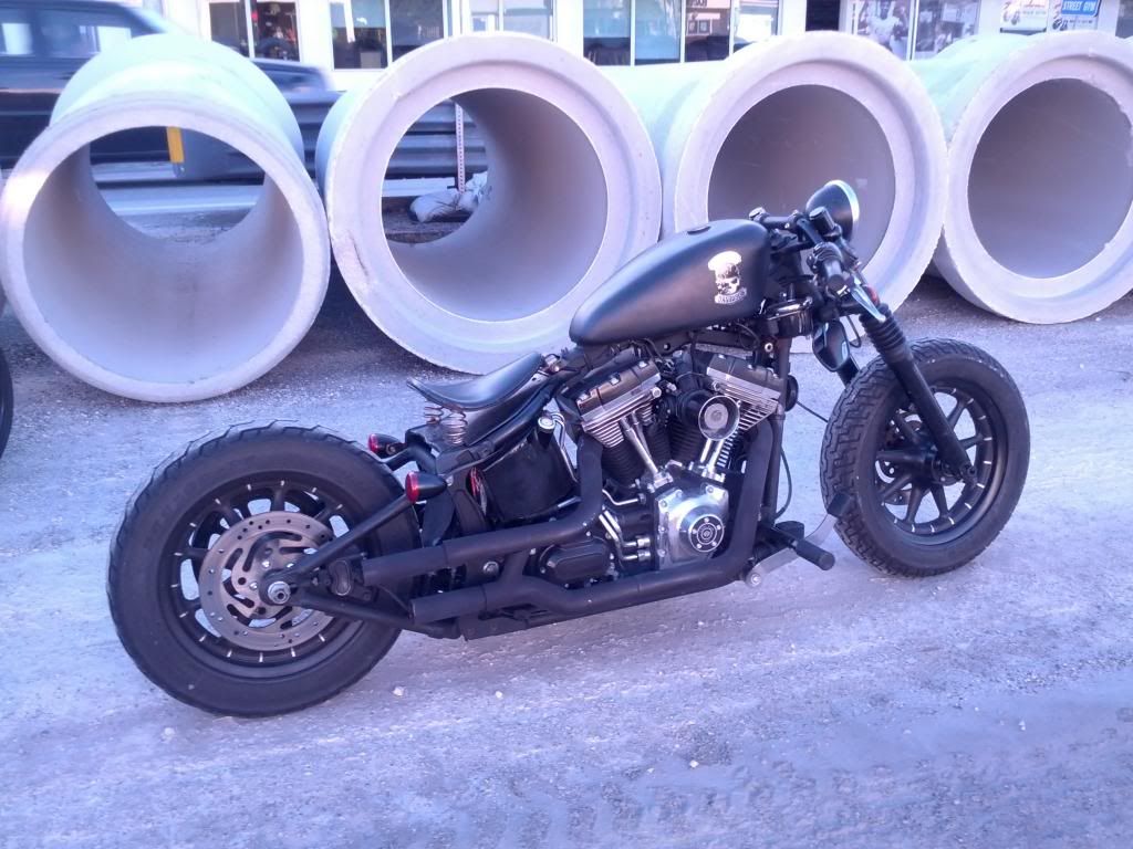

Hey,
Sure you can use wheels from the Dyna.. mine is also a Blackline 2011 and I use touring wheels (they have the same hub size as the Dyna).. BUT!!.. one important detail is the fact that the hub on the rear wheel is offset on the belt pulley side, it is actually 1/2 inch larger on that side.. so to account for the offset you will need to use a hub spacer like this one:
http://vulcanworks.net/store_4/produ...9&cat=2&page=1
That is actually the one I bought.. part number 3912
The Dyna wheels are all 25mm axle diameter... make sure you identity the axle spacers with a sharpie or something.. as the axle spacers are of different width on each side of the axle for both front and rear wheels.
Also... you need to get pulley bolts that are 1/2 longer.. get grade 8.. and torque them to specs!!!!
Here is a pic of the spacer once it is installed on my bike:
Here is a pic of my Blackline 2011 (or whatever is left of it LOL):

e2950.. . you are correct about the wheels types and years.. the same applies for Sportster/Dyna.. I know Sportsters switched to 25mm axle in 2009.. although perhaps there was a model that was updated to 25mm in 2008.. In fact.. my softy right now has two Sportster Iron wheels (my favorite HD wheels) as you can see in this picture:
