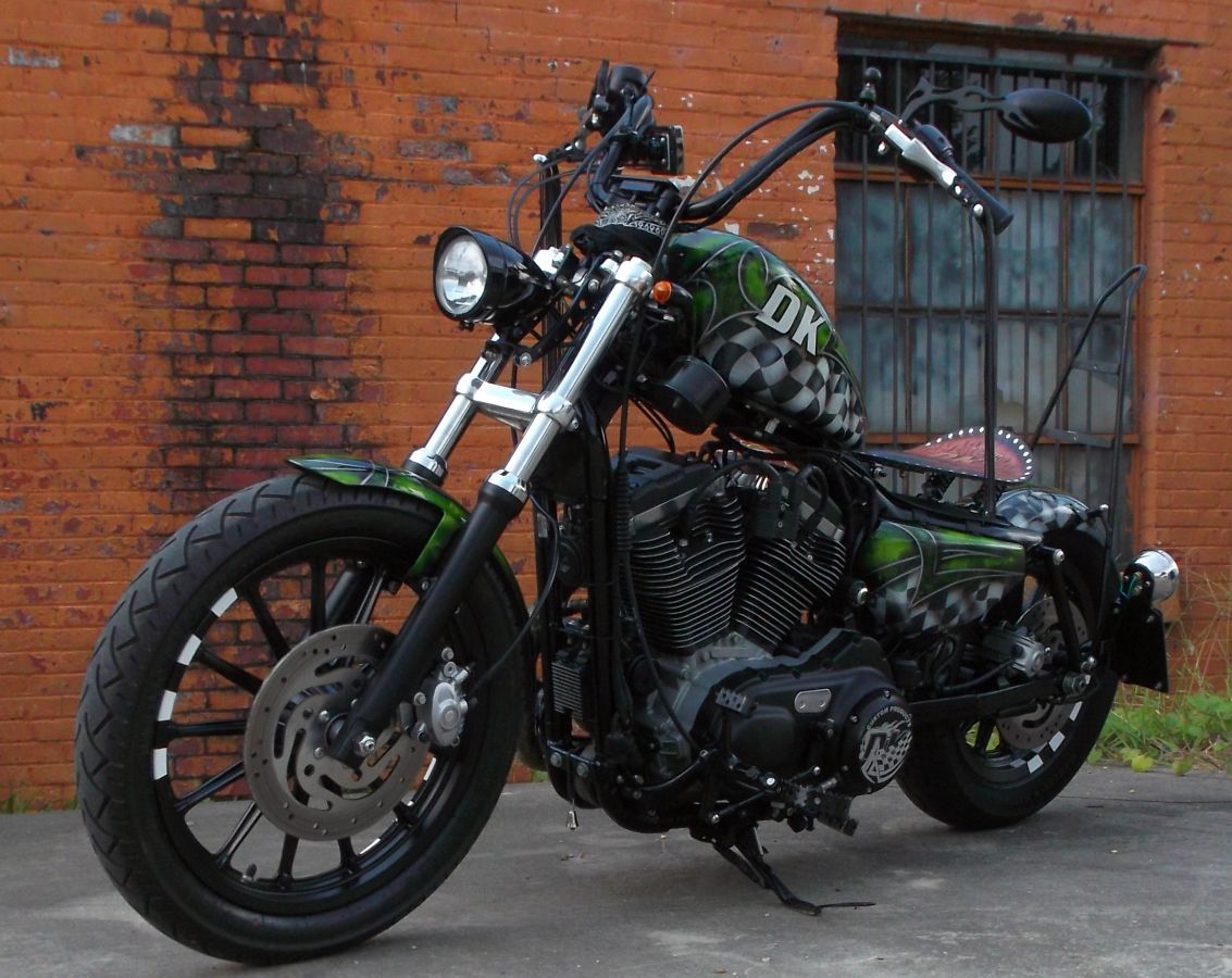

I'm running the HD Mini-Apes along with 2.5" riser extensions. This puts my hands in the most comfortable position for me.

Hey DK love the bike looks awesome. Mick where did you get your backrest from. I like it
