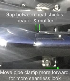

When I first put these on, I did a post (either here or on another forum) and talked about how the position of the header clamp affects how well the muffler heat shields dovetail into the header shields. (see attached) I was inclined to slide the clamps forward for a more seamless look on the shields. But this time I erred on the side of the better seal, and it once again looks like the picture. The clamps need to be closer to the joint, I think.
So the moral of the story is, if you have a Sporty and you fit Khrome Werks slash cuts to it, KW does not cut out nearly enough of a space on their slip-ons to allow the exhaust clamp to fully constrict against the header. It REALLY needs xtra wraps of something to form a seal.
