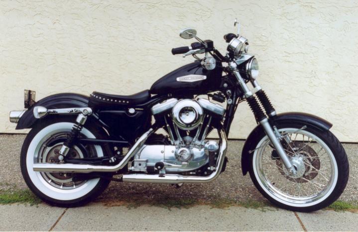

2001 XL, 1200cc (74 inch), 100hp/88ft lbs RELIABLE AS A BRICK Most fun ever on a Harley
