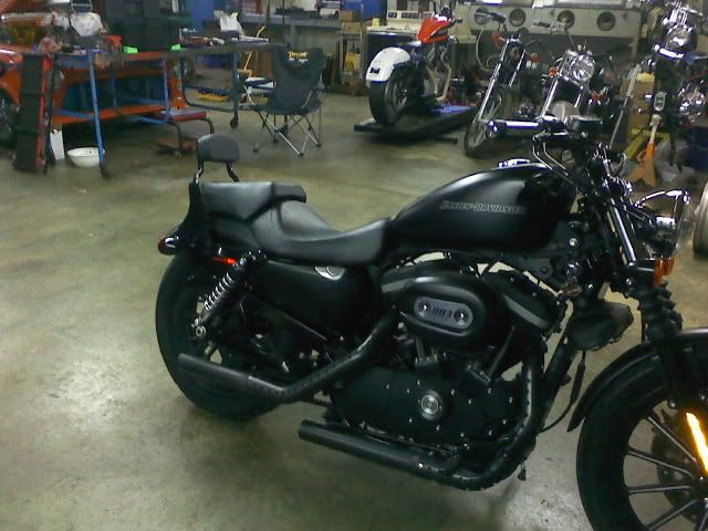

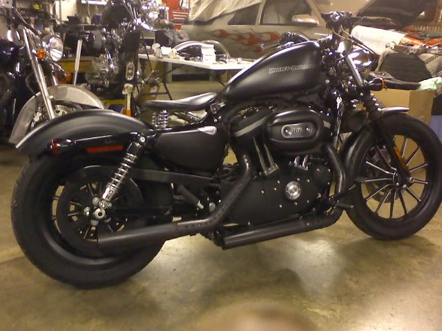

Here's his bike. Tired of hauling a passenger & ready to ride solo.

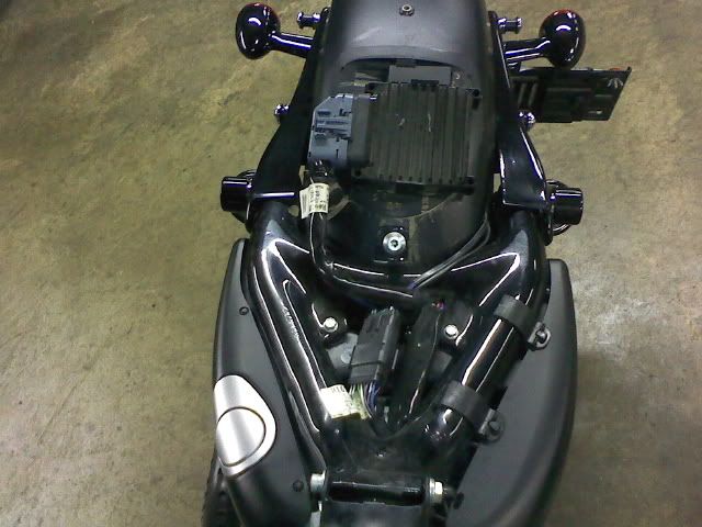

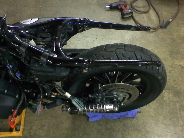

What it looks like with the seat off...I'm sure everyone knows what this looks like.
Took it apart enough to do the work.

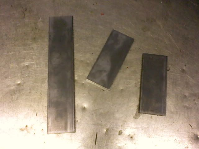

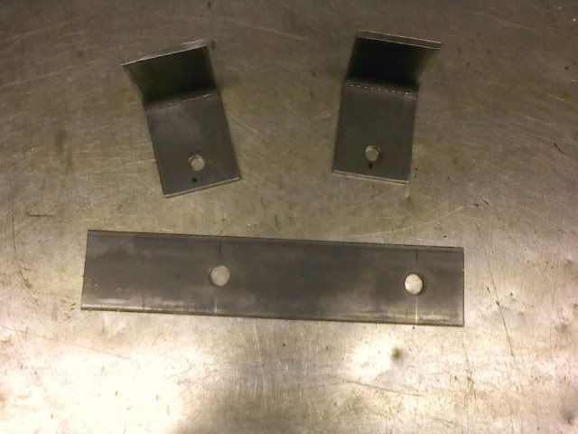

Cut three pieces of 1.25" wide plate.
Bent the two short pieces with a hammer in the bench vise.
Drilled holes where I needed them.

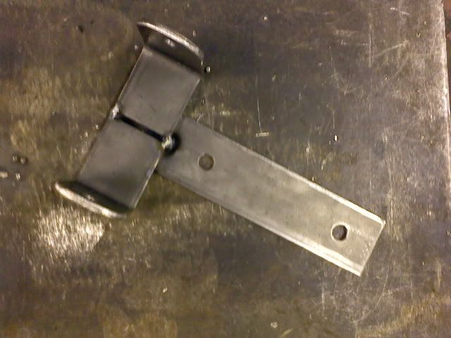

Before I welded the pieces together I needed some measurements but first I had turn the rear tank mount into a pivot bushing.
I enlarged the holes in the tank and in the frame (where the tank bolts) to fit these bushings.
The tank is very secure with the bushings tapped in. I chose this style of bushing because the frame mounts are rarely perfectly aligned with the tank mount but mostly so the front seat pivot mount can do its job without damaging the paint on the tank mount and the powdercoat on the seat mount.

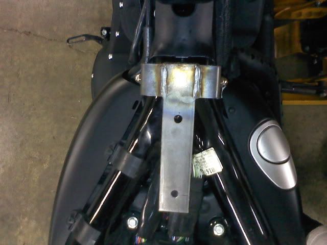

Fitted the pieces snug, took some measurements & tacked the mount together.
Fully welded & final test fit.

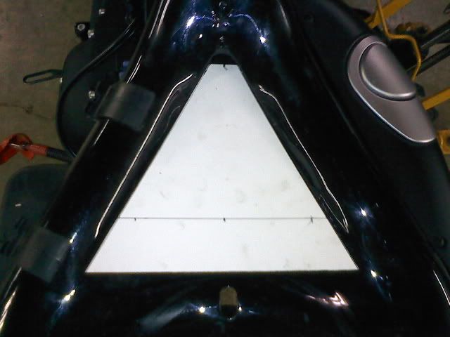

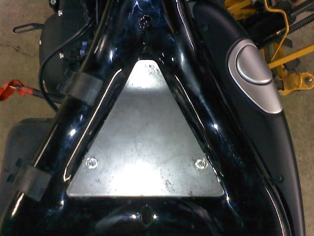

Template for the frame cover/pan.
Test fit after it was cut & bent. I bent this one in the vise as well.
It's bolted in existing holes where the oil tank is mounted to the frame.
Here it is reassembled ready to go.

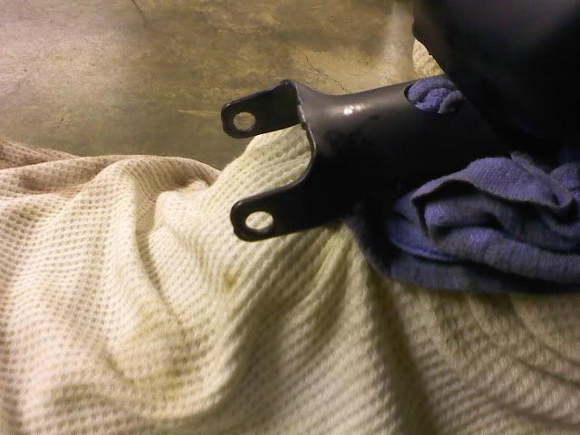

All I did to mount the rear springs was drill holes in the frame and tap them for through bolts. The frame in this area is formed plate, not tube so a simple bolt with a nut on the opposing side would be just fine but the rear fender will need to be removed to take the seat off if needed.

Thanks. His has 3" springs. He wants to put rigid struts on it now & I think that'll make it look better. I'm usually not a fan of seat springs & rear coils together...but it looks pretty cool. I powdercoated the parts mirror black but I guess I forgot to take pics of that.
I'm doing an 04 real soon so I'll try to take better pics. Everything is exactly the same except for the big hole left in the fender on the 07-09's.
