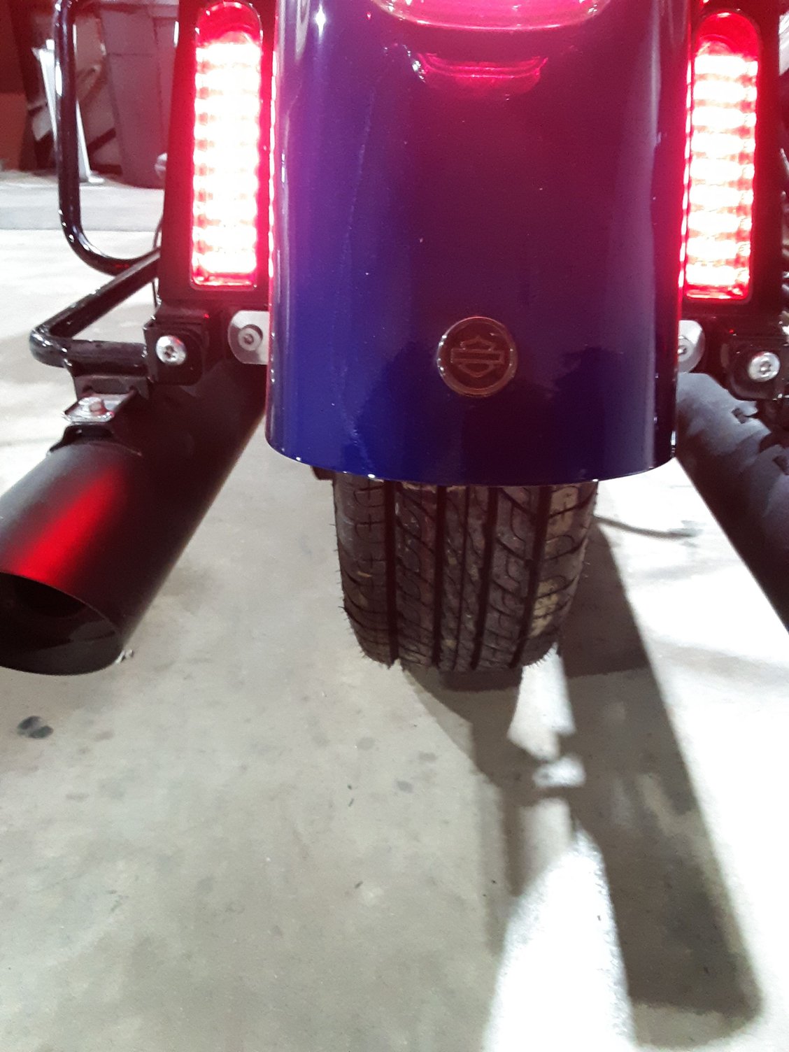

195/65R16 on rear of a 2020 RGL that came with factory 18 inch.
