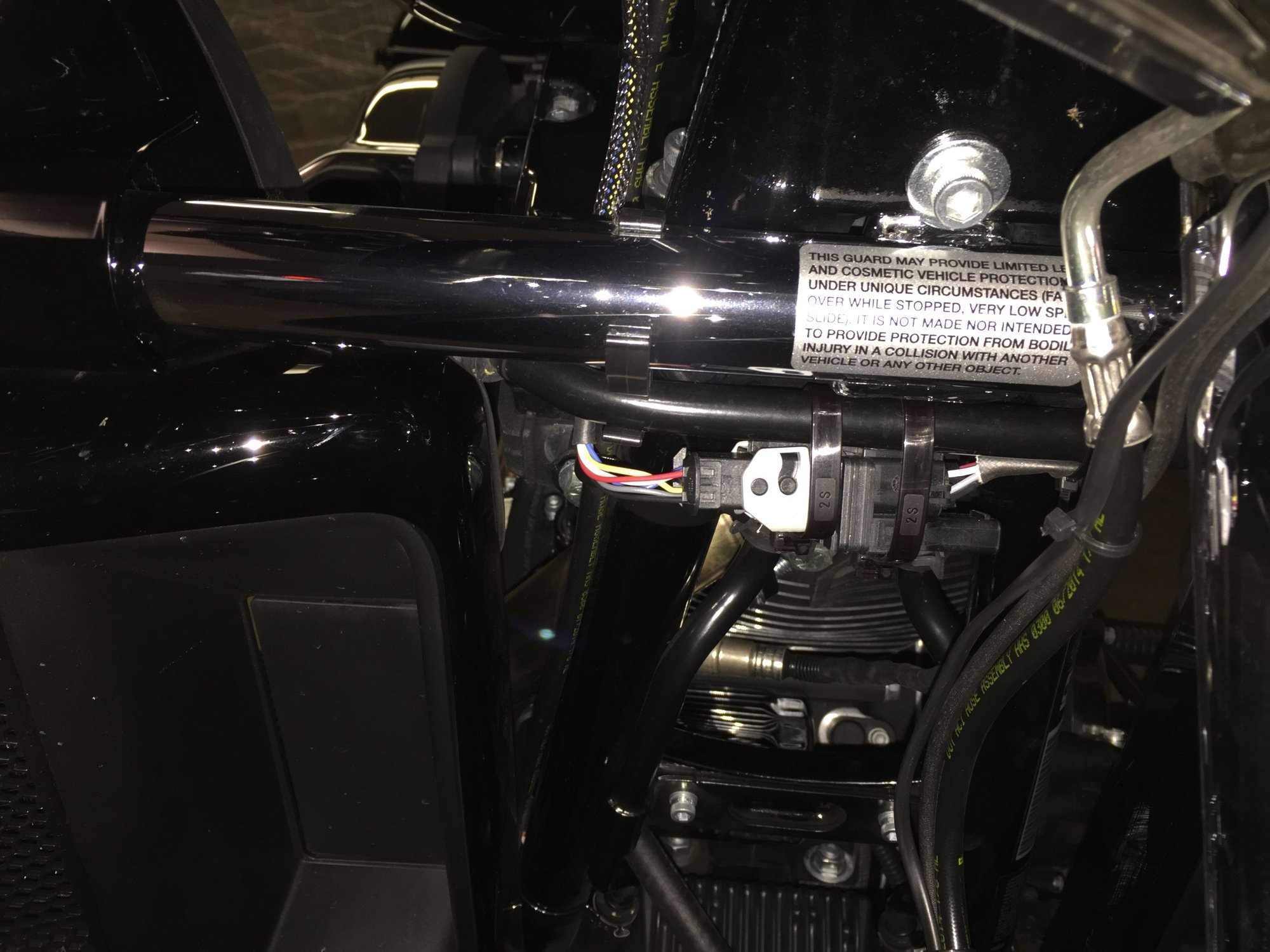

I tie wrapped the connector to the top of the crash bar and then routed the wire under the fuel tank in the wire trough to the auto tune module which I mounted behind the right side cover.
