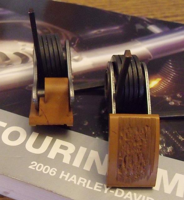

To reiterate my previous post, here's the molding temp of plastics of all types...the heat required to get the plastic to flow easily and evenly into a mold to make the part. This is a far higher temperature than needed to cause a finished part to start to degrade from high temps.
http://plastictroubleshooter.com/The...melt_temps.htm
Attached is a picture of a typical cam chain tensioner POS plastic that is degrading at only 30,000 miles. These are from my '06 Ultra. Note they are not just worn, but are chipping away. I had all those "chips" floating around in my engine. Note also the crack in the one on the left. I believe that was caused by repetitive heat stress of the part. If that piece had broken off,,,,,well, that was a major problem just waiting to happen. Luckily my pre-emptive strike on replacing these POS parts with gear drives solved that potential problem.
An engine that has virtually no control of internal temps, has no business having plastic parts inside of of it! IMHO!
