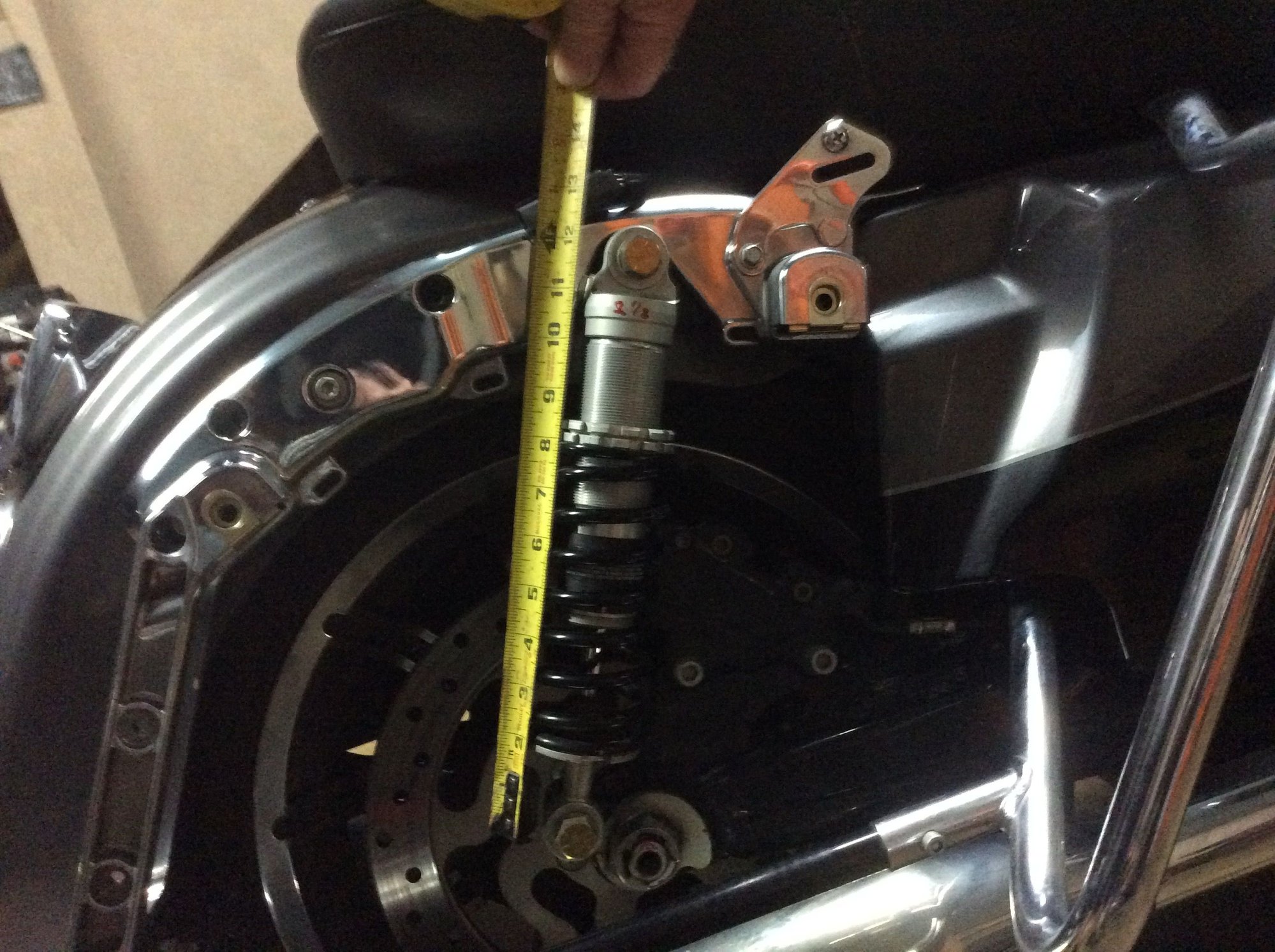

Are street glide and Elec glide shocks the same length
I am looking to lower my 2010 Limited about 1 inch and was hoping I could just change shocks.
These are Ohlin #2~#2(A) 12 1/8"/309.5 mm from motorcycle meatal on a 14 limited. They lowered the bike about an inch and work well. There a little tricky to get dialed in but once you get it there nice with a good feel, good control.
