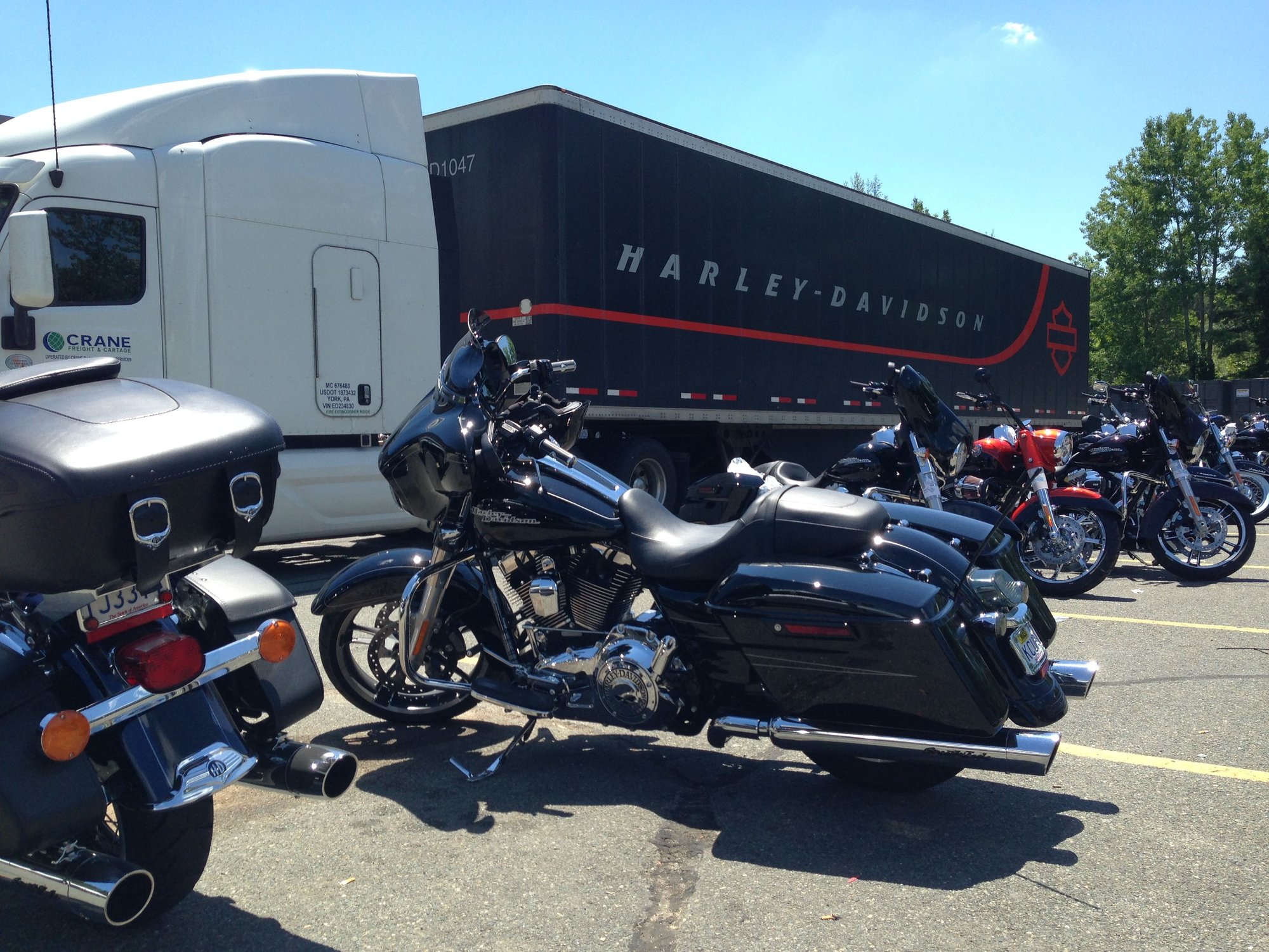

Not sure how much you can see but i went with CD LED's front and back with smoke lenses. Dynamic rings on the front and LED inserts in the back plus the rear LED tail light all with smoked lenses. Headlight is the LED Truck Light.
