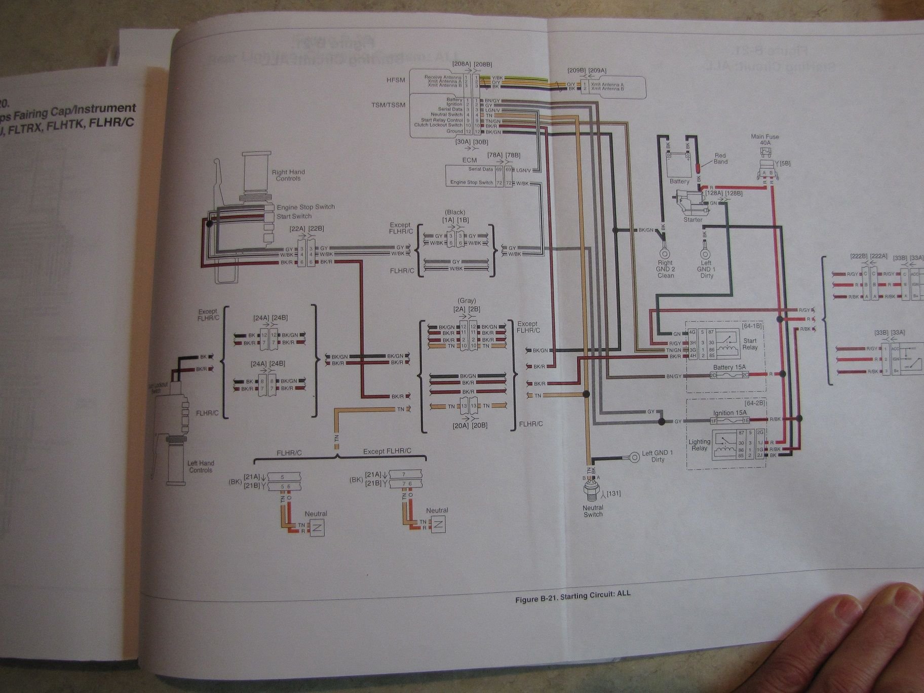

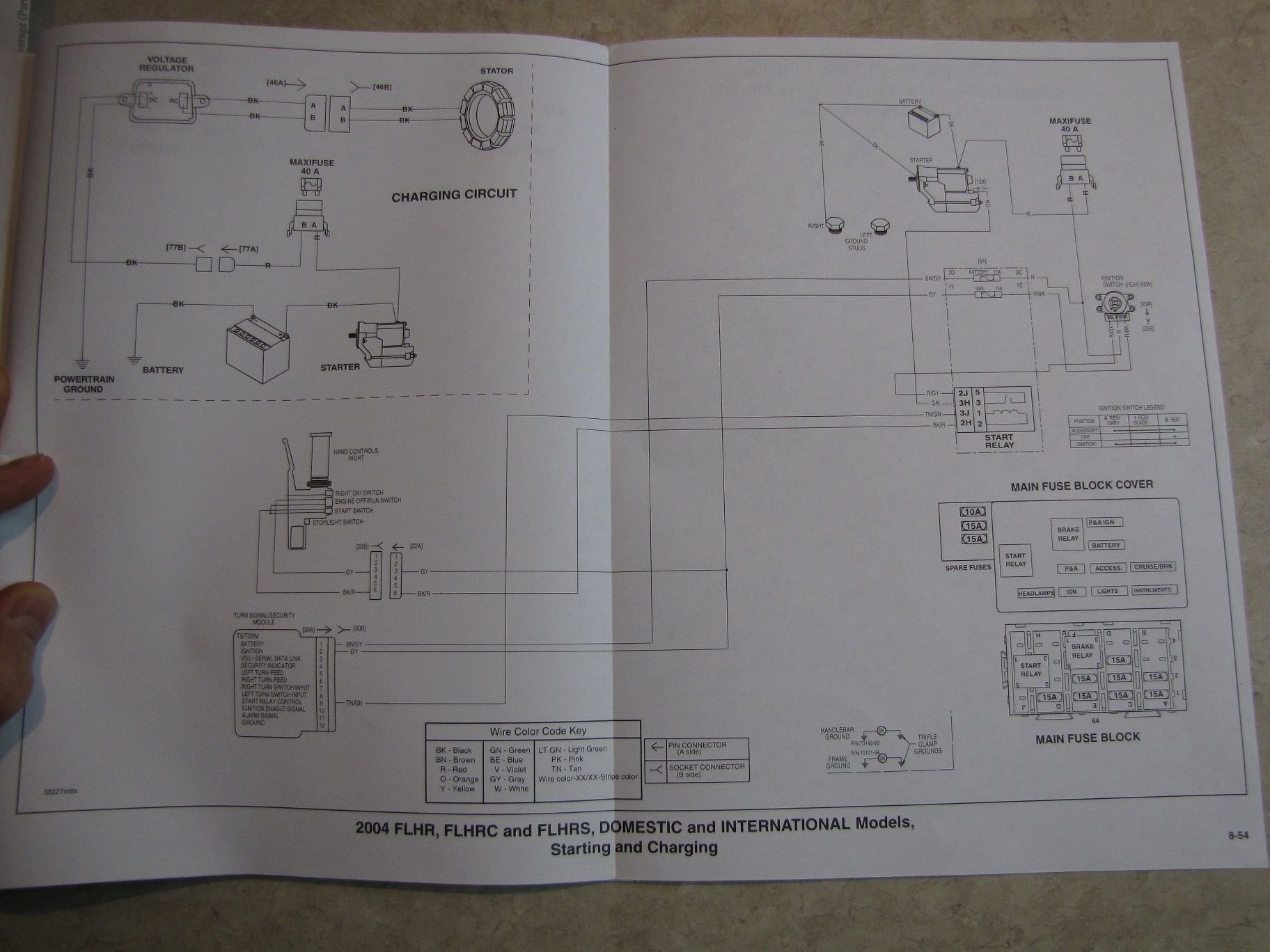

I looked at the starting schematic for 2004 and I don't see any neutral or clutch switch.
The 2010 Schematic shows the clutch switch and input to TSSM. So I don't see one on your bike. I hope someone else confirms this or shows me what I missed .
