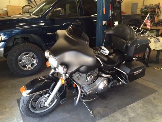

For an 08 RK with police solo seat
I never carry a pillion and have no provision for one. I would like to find a King tour pack mount that moved the box further forward behind me so that I could use it as a back rest, and distribute the load better.
I also have panniers so the bracket would need to be high enough to clear the lid
I can find brackets to move the box rearward, but nothing to move it forward. Is there such an item or will I have to make my own?

I built my own.

That is what I have in mind but was hoping for an off the shelf solution. If not then I will make a plate to fit the Police rear rack, and mount the tour pack forward and high enough to clear the bag lids
Could you post some more pics or pm me with pics?
Not sure if I would like the arm rests when cornering - how do you find it on mountain roads. I was thinking of two pads on the box, one on the lid and one to fit the lumbar
