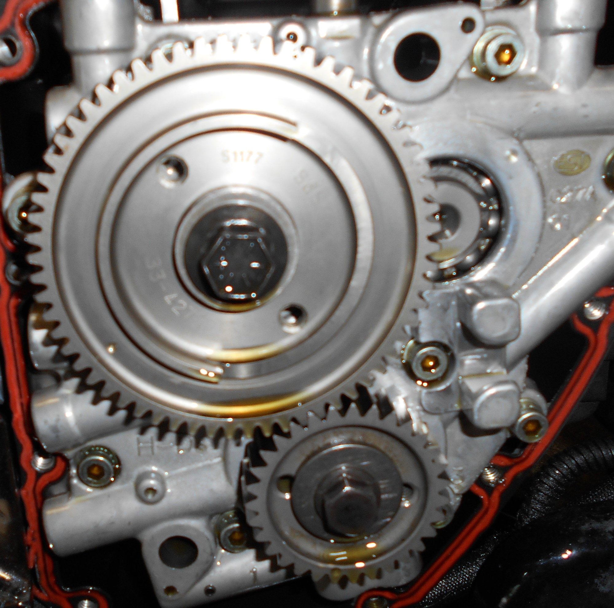

I am replacing some oil seals. Should I up grade anything or let be.
31K Miles.

Comp is a non issue; shoe looks good; assuming clutch is not giving any issues, leave it be. Replace all the seals and button it up. Have you checked the cam chain tensioners yet? I would be at 31k

Yup gear drive installed.
