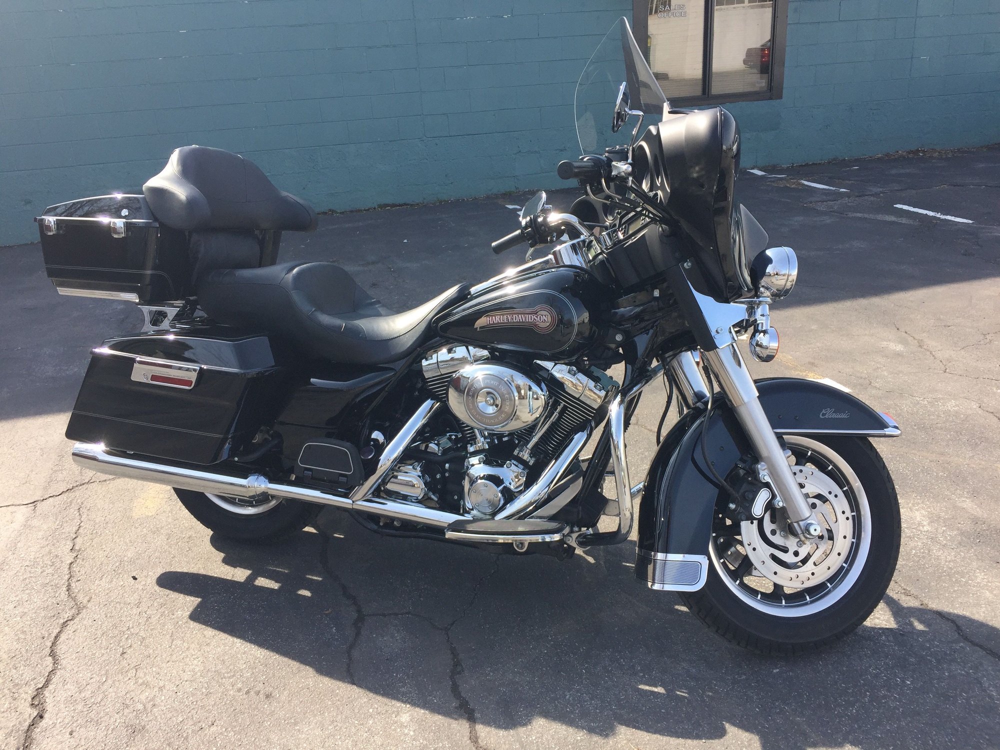

Just bought it. Only 8100 miles. Stock pipes, looks and runs like new. My problem is I'm only getting about 32mpg. Gas light came on around 135 miles. This isn't normal is it?

Do you have any service history on the bike? Possible if not with the low mileage and age, it may be time for service. Complete fluids change, air filter service, plugs and plug wires could help that fuel mileage. It's about the best you could do all stock.

Stock pipes, but looks like stage 1 A/C, unless I just can't see the backplate. If there was no tuner, but just a dealer download, adding a tuner to change the fuel and air could assist you in your endeavors of better mileage. It would also enable you to continue with mods such as changing out the stock header for duals or 2-1 pipe to rid of the heat of the crossover, cams and much more....

thanks guys you're awesome. I love this forum. It does have stage 1 air done to it with a fuel pak. I'll drive some more for sure to see how it does. 10k maintenance is just around the corner and I'll have them check everything out. My riding so far has been highway 65-70mph
