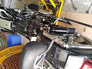

Alright I actually did this myself with the help of a friend that's done it. I reinstalled a set if o em air adjustable shoei shocks. We had to run the airlines as the person that lowered the bike stripped them out. Ride home was sweet and it gives me a bit more lean angle. Didn't ride hard enough to tell about the shimmy but he did a fall away test and then tightened the front. He wasn't familiar with checking for play in the swing arm so if it still gives me problems I will have my Indy do it when it goes back in. I will let you know how it affects my handling but I really appreciate all of the advice and I am kind of proud of having done the swap myself (it really was only 4 bolts lol). The rest I credit my buddy Joe with and am buying later tonight at scooters.
