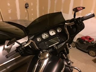

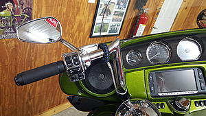

Here is a link to a detailed thread on the install I did recently with 10 inch Yaffe Monkey Bars:
https://www.hdforums.com/forum/new-r...o-limited.html
The wife really liked them and I think they look nice!
I am 6' 1" and would have been just a little more comfortable with 12 inch but I like to keep my hands just behind the fairing.
Attached Thumbnails Apes???-20171118_202615.jpg   Apes???-20171118_202728.jpg   Apes???-20171118_202737.jpg   Apes???-20171118_202816.jpg
