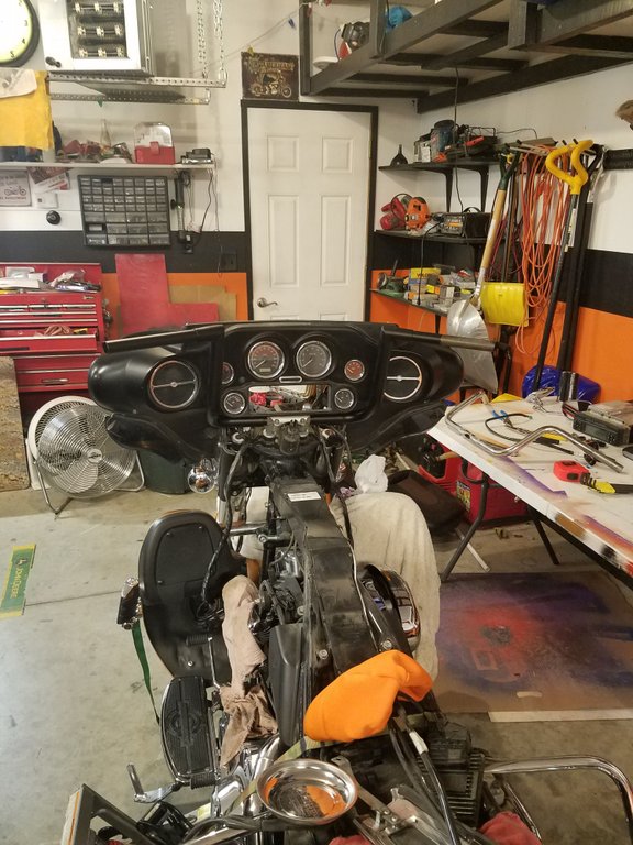

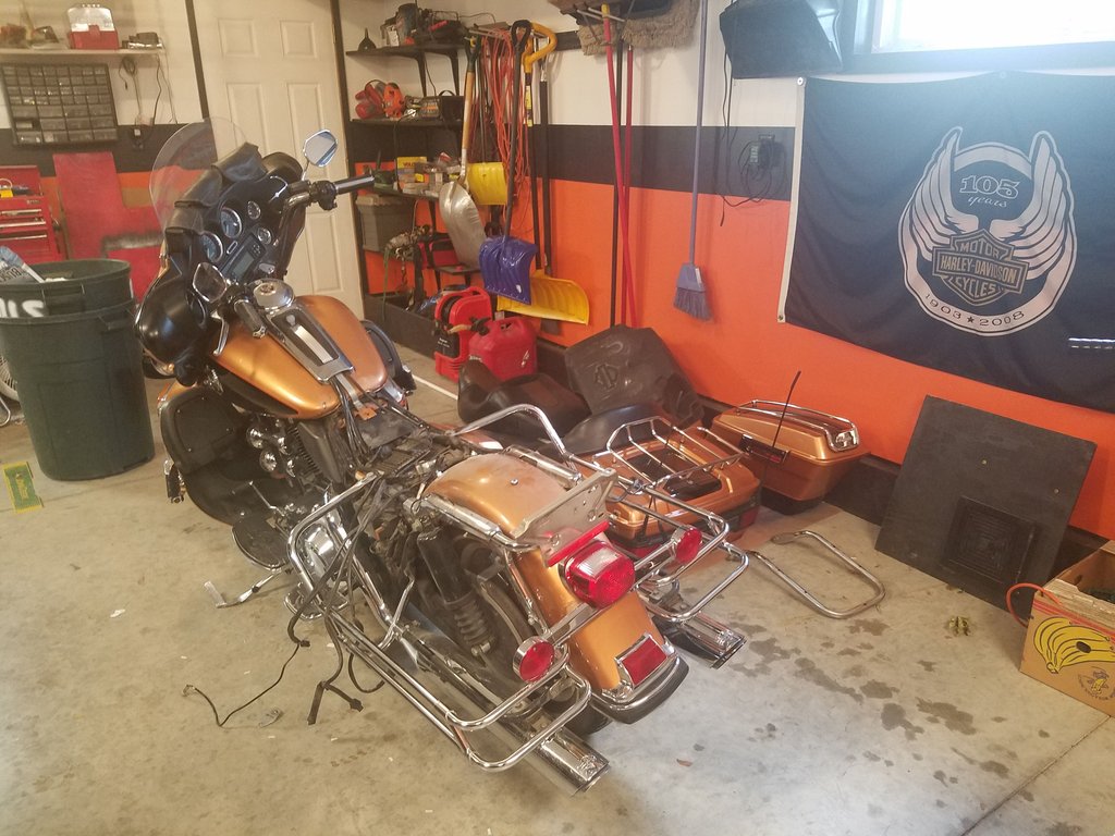

A couple of before shots for reference. Nothing special to call out here.

First up: Tourpak has to go.

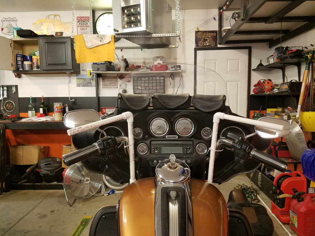

a $2 mock up to decide on bar size. No parts have been ordered at this point. Measure twice, spend once. I saw so many posts for "should have gone taller". I had already decided at this point that it would be Twin Peaks bars due to popular review for ease of wiring and they come in flat black.
The choice ended up being 12"
Now that is a good idea there Brother.

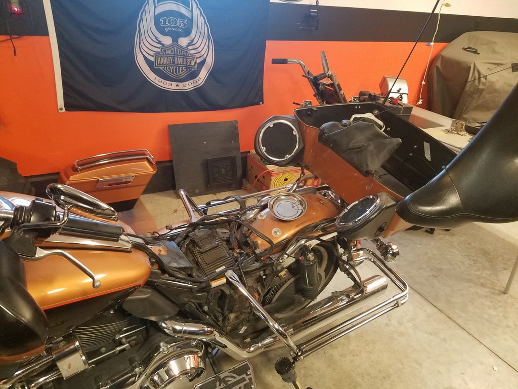

Well now that I have the bars ordered I can start stripping it to prep for install.
Haven't ordered any cables or lines yet as I want to get the bars mounted to measure so that I can be absolutely certain on the length.

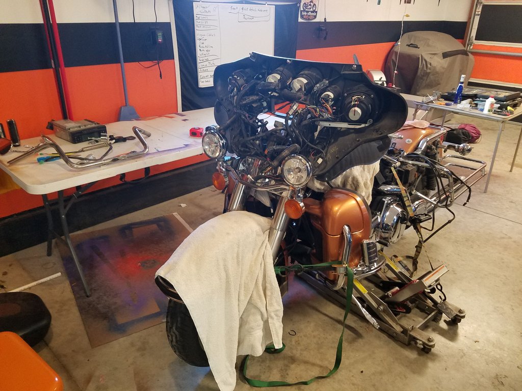

So using my service manual for all of this tear down was interesting. It jumps around a bit. This pic is right after I learned that the brake lines require removing the tank, which was full because I had it winterized before I decide to take on this little adventure. It was this point I realized how deep this rabbit hole was going to get.
Just got the bars at this point, test fit. no wiring yet.

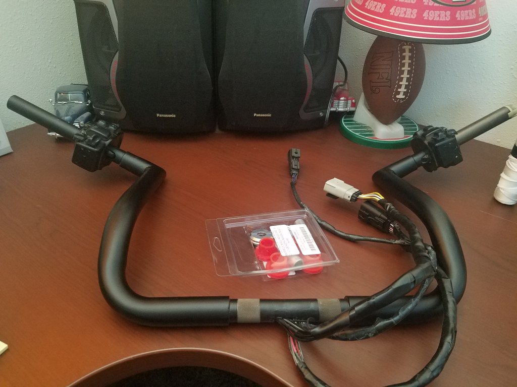

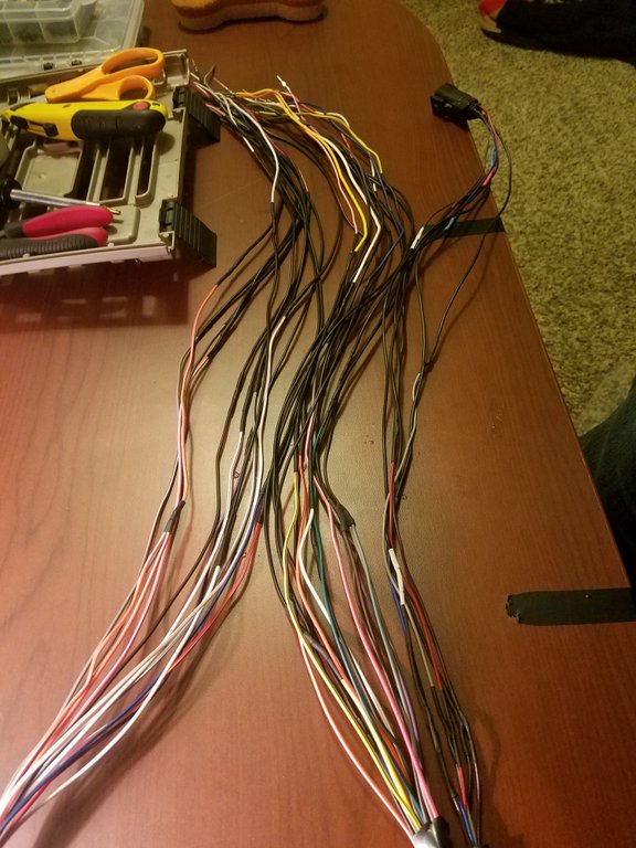

Well time to see if my skills are still on point.
Hmm not bad if I say so myself.
Couldn't find a good flex conduit local so tape it is. I miss Radio Shack.
And in this picture also, you can see the bushings from Alloy Art that gave me a nightmare. They were too thick, could not get them installed. Ended up ordering the Drag Specialties version, thanks to member RazorBack for the links.
