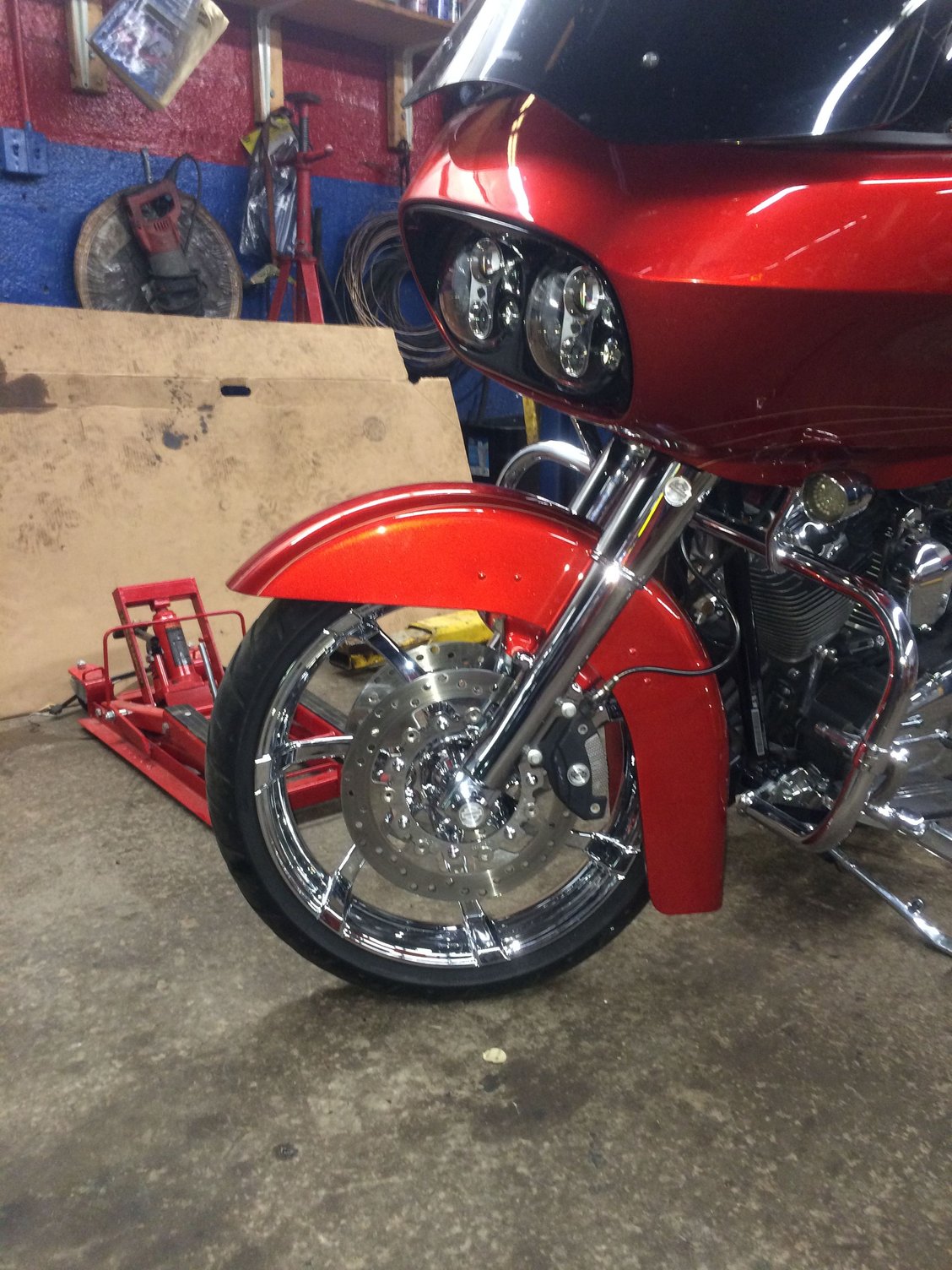

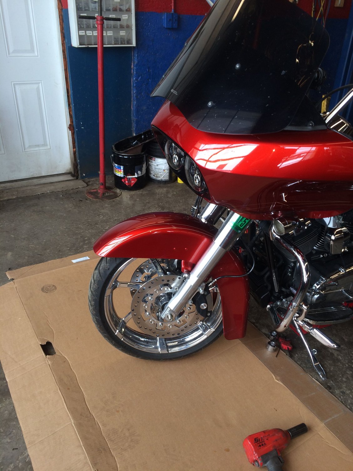

Did the monotubes and chrome lowers back in 15 have probably 20k on them. Would do it again. Pretty sure I used 2 spacers. Ride 2 up all the time
Before
After

looks like the stock height monotubes?

Did mine to stock height didn’t want to change that
