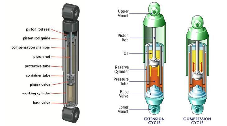

The shocks do in fact contain fluid to provide damping action for the suspension. The air acts as the spring to provide preload and carry the weight of the bike and passengers. ATF is a great substitute for suspension fluid, I have been using it for years.

Shocks have been hydraulic for a long time now.
