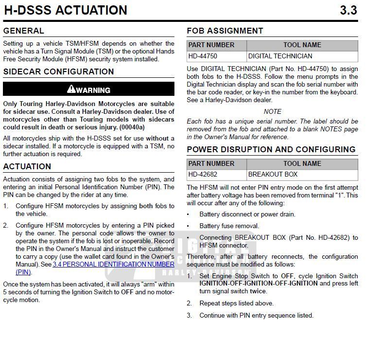

i am in the process of putting back together a stolen recovery 2008 street glide.i have it almost completed but i dont have any power to the start button,i replaced the ecm and the tsm with a used pair from another bike.will i have to take it to a dealer to have it married to my bike to get power?

If you have the FOBs and PIN with the TSM then you may be able to peform the password relearn which is required when replacing the ECM / TSM?
