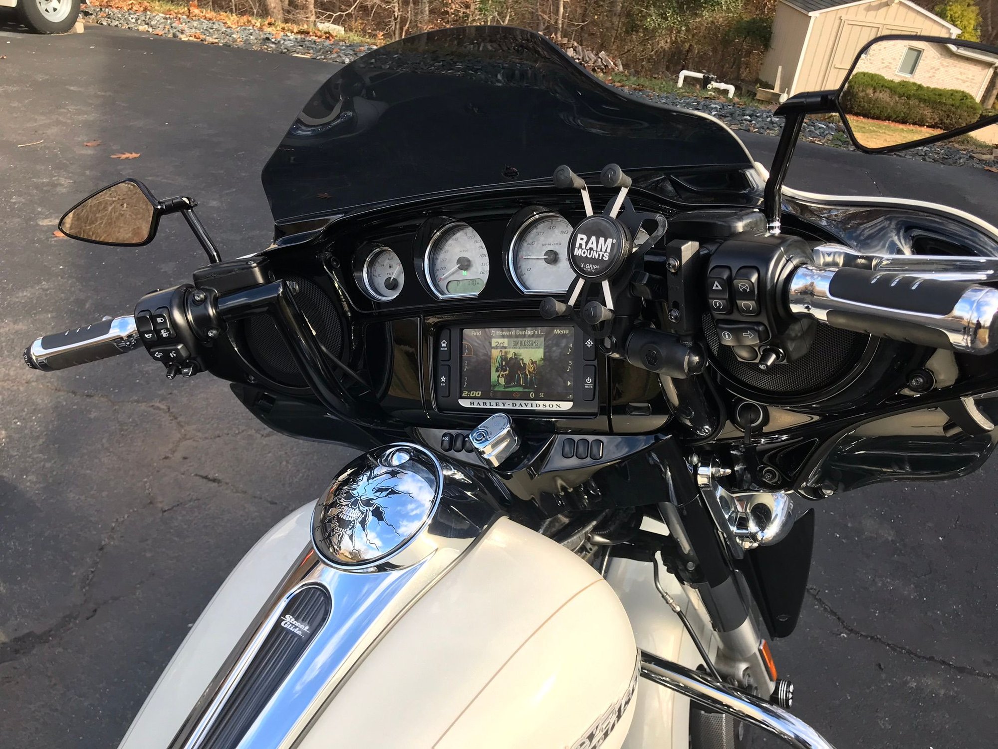

Yes, the Khrome Werks 300400 are the 10". I'm 6'3" and could have gone with 12's or 14's but didn't want my hands above the fairing. As mentioned, I need some wind protection and not real big on the "above the bar" look anyway.
Depending on how far you roll these forward or back will determine the height somewhat as well. I also considered the Twin Peaks, but again looks wise, I'm more of a "traditional bend & chrome" guy.
I wired them internally and did the install myself...just have to be patient. I was able to re-route all the stock wiring and re-position the stock brake line. Initially I re-positioned the clutch cable (not through the inner fairing)...it was tight but worked. I later decided to get a longer clutch cable. Looks much better & functions better going through the fairing as it should be...and have lots of length now. If I recall, I went +6 on the clutch cable.
Here's the only pic I currently have. Sorry...it's dark in the garage and not real good. And I can't take a pic now as I have the bars off and all apart as I'm planning on adding heated grips this winter.
