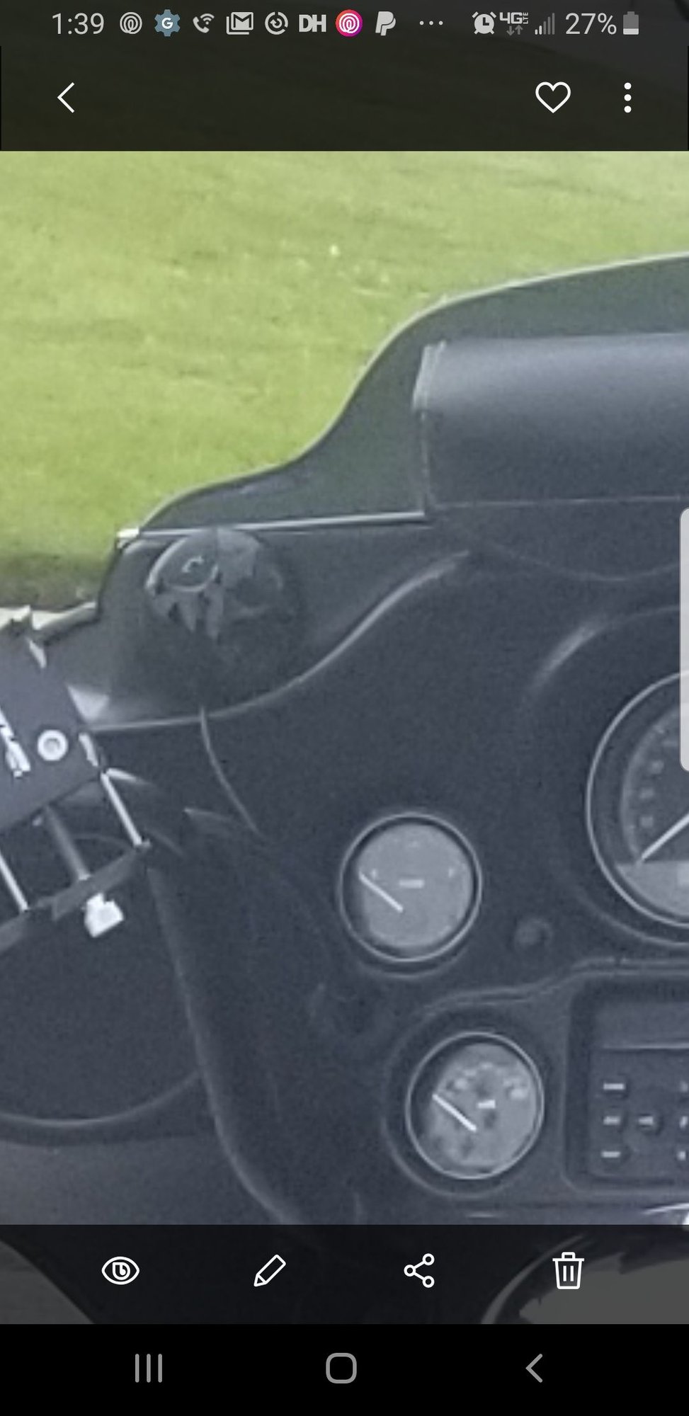

Is your ipod an older one, does it have bluetooth capability? If so, I use a $20 FM bluetooth transmitter plugged into the lighter port of my '11 classic for streaming music from my phone. It had a double sided tape base with a magnet to mount the controller.....the bay has 'em. my aux jack is sketchy too so this was the best option without changing the radio. I mounted it on the inside of the fairing...i do have to reach over the controls if i want to skip a song but it's not too bad considering...plus it got rained on pretty good on the way up to and returning from Laconia and i havent had any issues with it....gets the job done for under $20!

How does this work? Plugs in to antennae jack?

Sorry for the delay in responding, i was out of town. No this works as an FM receiver of your bluetooth device (phone or ipod). The unit gets set to whatever frequency you want. Best to pick a frequency that isn't being used by a radio station. Mine is at 87.9 FM. Then tune your radio to that frequency and whatever signal that is being sent to the unit is then played through your sound system...its basically setting up a radio station on your bike that your factory system picks up. no aux jack needed. You do have to power the unit up with the cigarette lighter port on the bike or some other way if you don't have one...like i said its a setup that works pretty good for me for $20.
