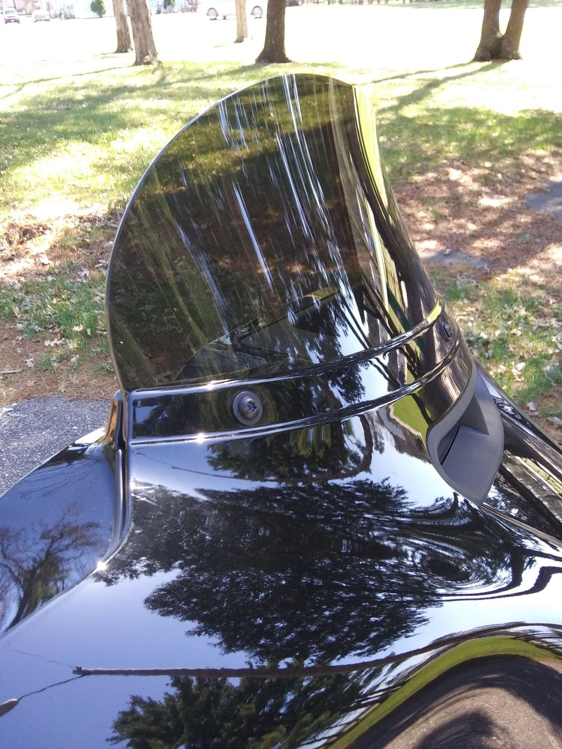

The one in my sig picture is a Memphis Shades 6.5" Spoiler. I'm 5'11" and it comes up to about my chin or mouth. Personally I like to look over the windshield rather than through it. My suggestion would be get one that has a recurve at the top that will direct the air up and over you. Most aftermarket companies make a few styles with a recurve.

This is a Klock Werks 8.5", and I'm 5' 12". Works great.

I'm 6 foot even. I put a 7" Freedom Shield on my 18 SGS. Vast improvement over the OE shield, no more rattling glasses! I can easily see over the top, even when slouched. I'm fairly confident that I could also easily see over the top of a 10". Just my opinion, but I felt the additional 3 inches of the 10" would take away the stealthy look of the SGS, and I'm pleased with the outcome.
