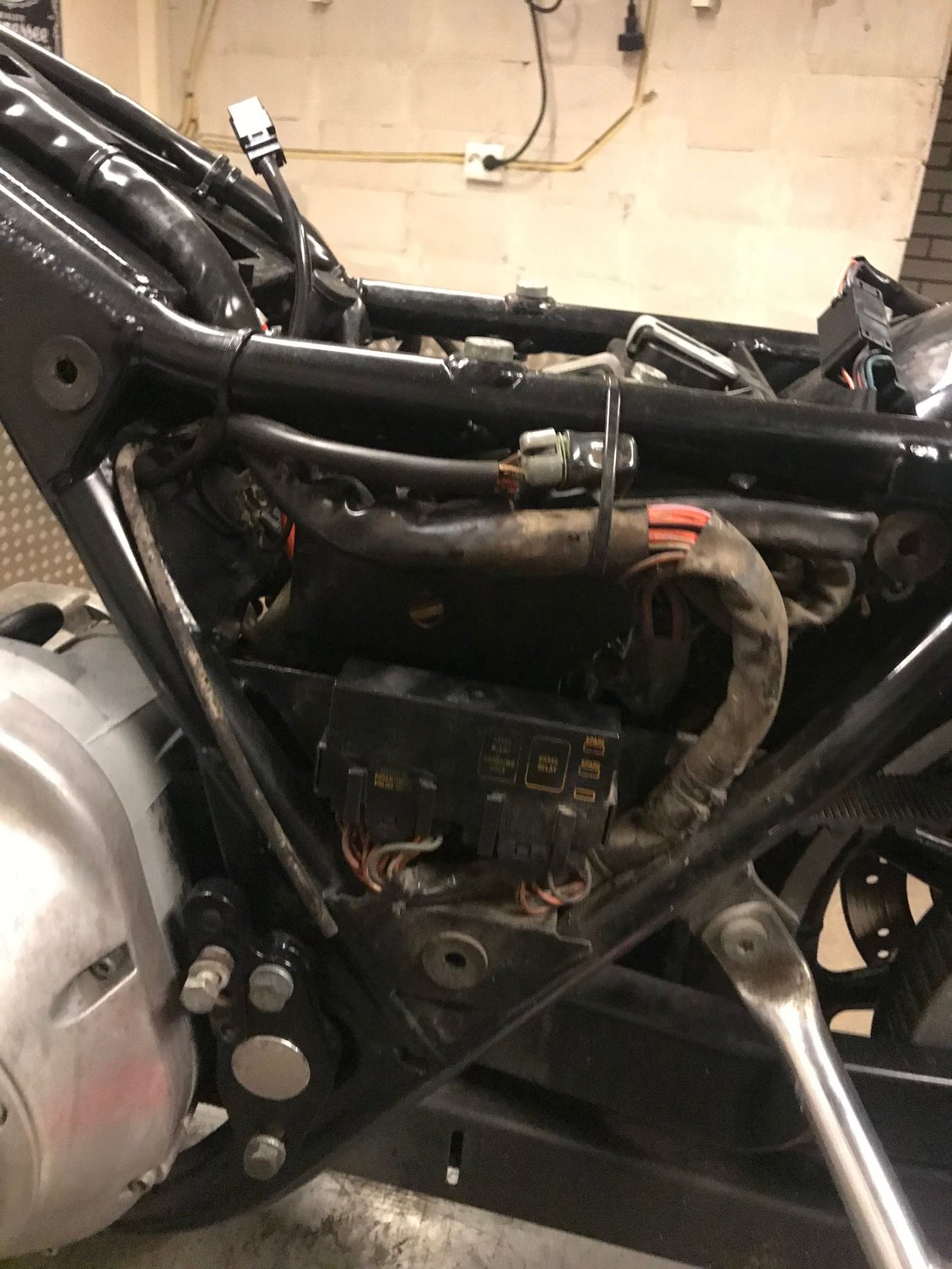

Please help me where to put my air ride compressor for my 2002 electra glide
many thanks
from the Netherlands

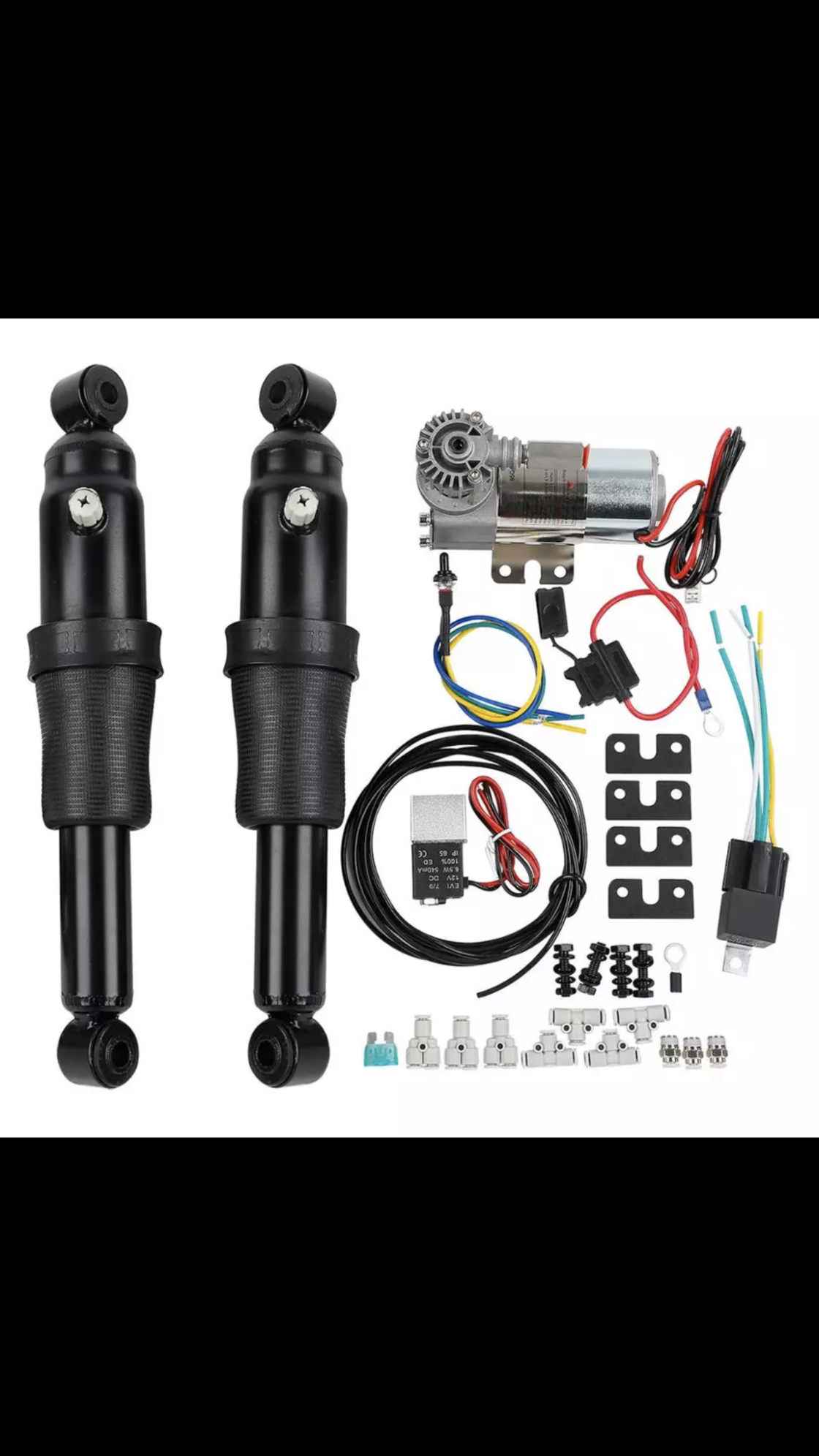

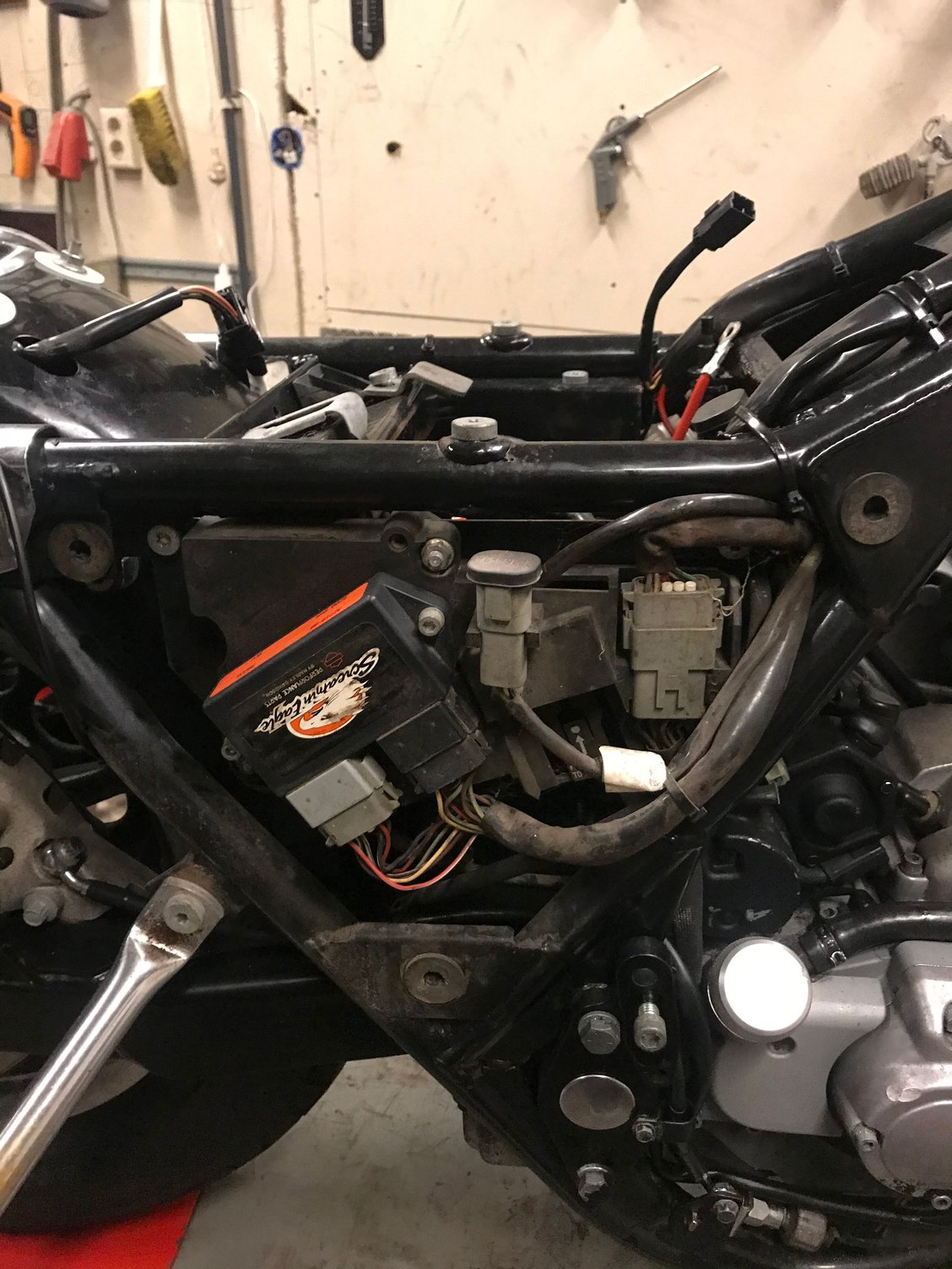

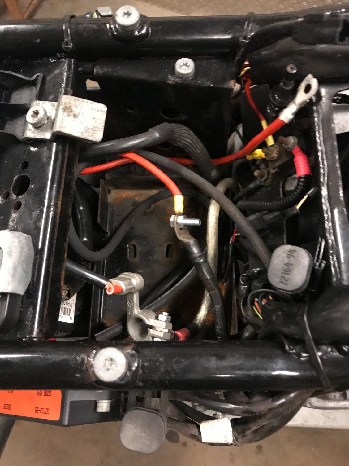

see the pics
its a set from china
but where to mount the compressor
behind the side panels is already equipment

Ya with a pump that size your going to be screwed on trying to hide it somewhere other then in your saddle bags or tour pack.

Originally Posted by mark16w
The pump doesn't look very big to me. I would refit your battery, protecting the terminals, and offer the pump into the space left to the rear of it. There are a few things in the way which you should be able to rearrange, by the look of it.

There should be room to mount it under the battery tray as well.

That looks identical to the Viair compressor. I have the mount from JNR Designs which mounts it to the saddlebag support on the right side of the bike between the wheel and the bag. Two years and no issues.

I mounted mine under the battery tray (too the bottom). Lots of room.
