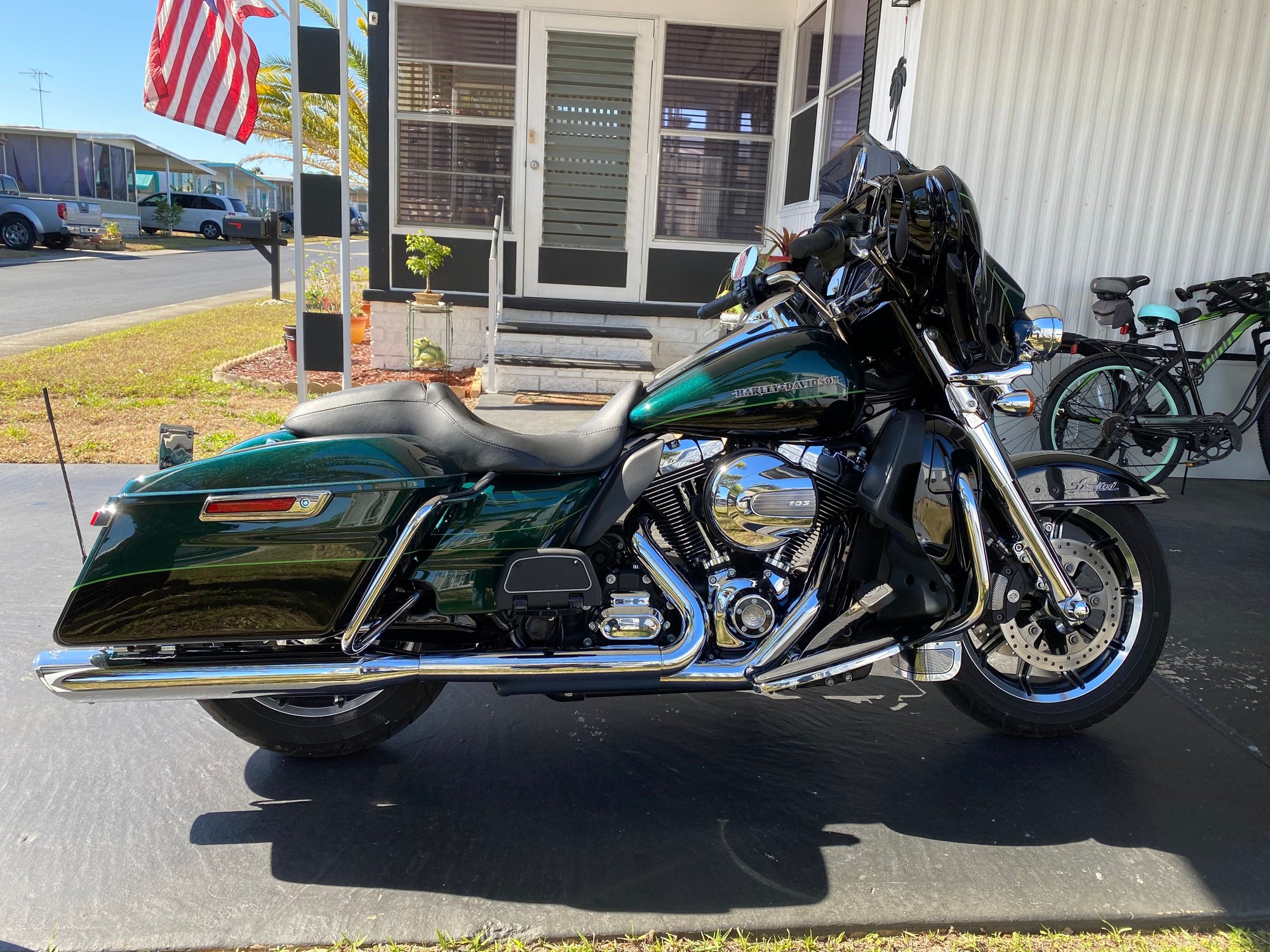

Easy...just did my 2015 Ultra...

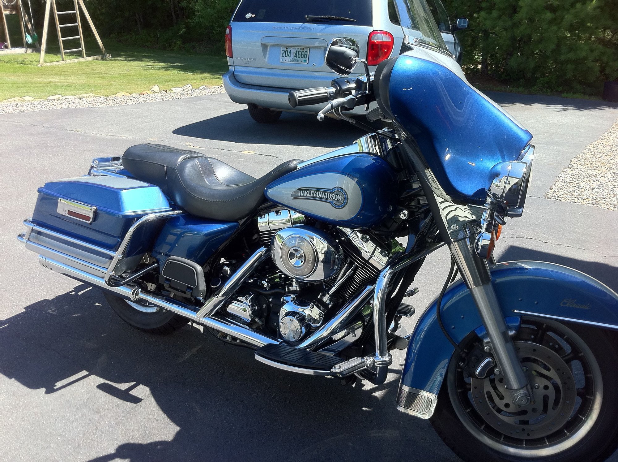

Did it on my 05 Electra Glide and again immediately after I bought my 17 Road Glide. I love having the option. I will say this though.... the only drawback is on both bikes, the tour pack tends to have a small bit of play in the docking hardware.

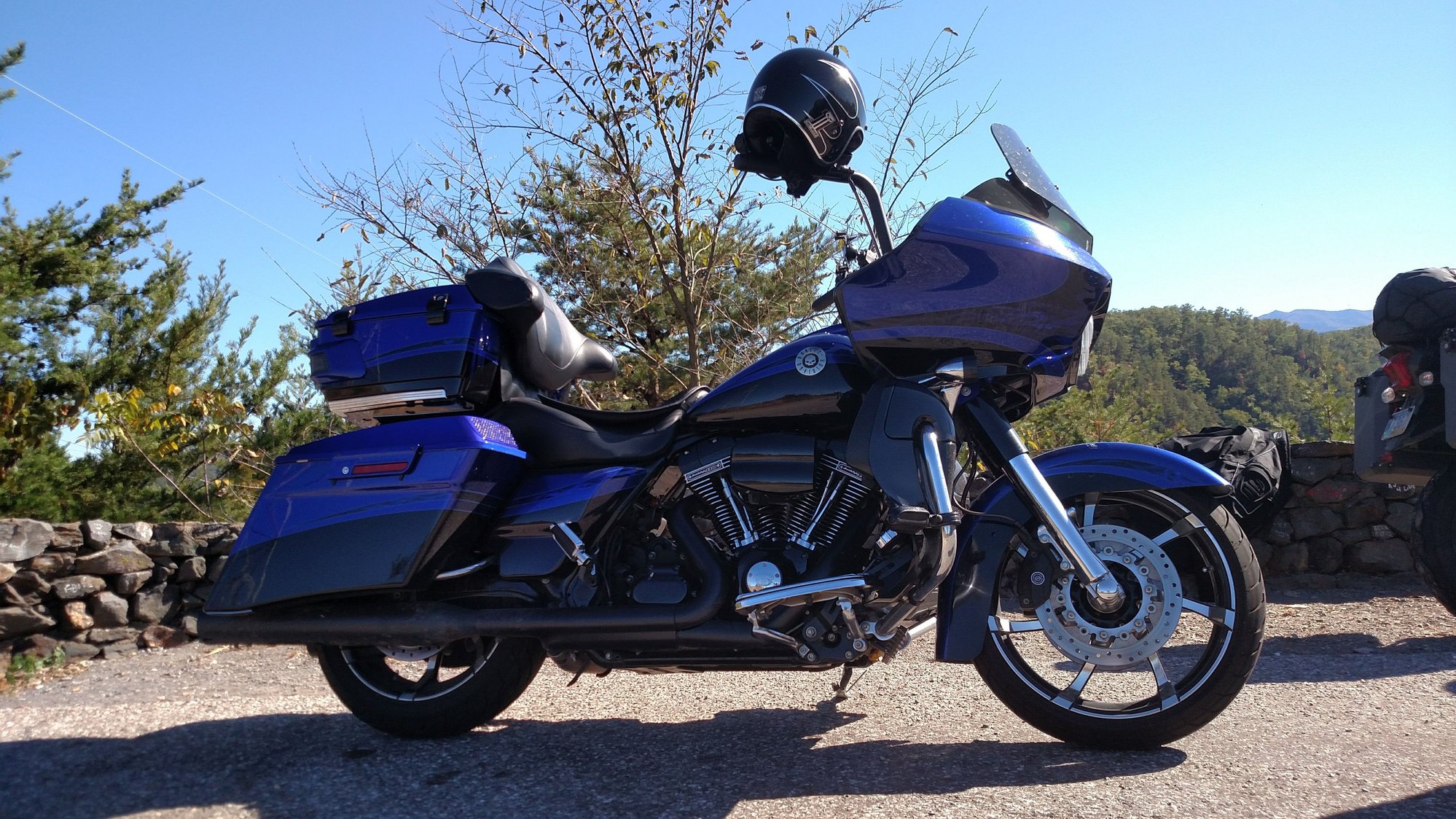

The docking point cam that the detachable rack mounts to can be rotated to tighten up the play. They are elliptical shape and have marks on them for this reason.
Shows the docking points ability to rotate 90 degrees to tighten up the play.

DinoM's Avatar
DinoM
Joined: Jul 2013
Posts: 457
Likes: 73
From: New Hampshire
Did not know this!!! Thank you for that Timbo!!! The dealer installed it on my 17 and never mentioned they could be adjusted. My 05 was didn't have this feature. I'll have to experiment with it I guess.
