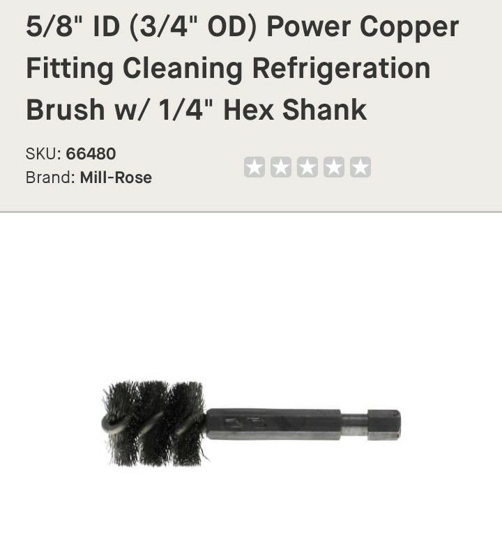

Mine stopped working. It had a bit of rust/corrosion inside the socket. Cleaned it out with a copper fitting brush while still in the fairing. Been working since.
