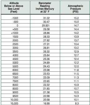

Old May 11, 2021 | 08:04 AM
jake24lt's Avatar
jake24lt
Joined: Jan 2017
Posts: 2,697
Likes: 2,093
From: Massachusetts
With a mean elevation of only 500 feet above sea level, Connecticut is one of the ten lowest states in the Union!
I really doubt that that roughly 3 tenths of a PSI will make any difference. My bet is fuel.
I'm in the 1k elevation section of N.E. but believe you are right and I din't run non ethanol although I would have liked to..
Thanks for the info and thoughts guy's.
