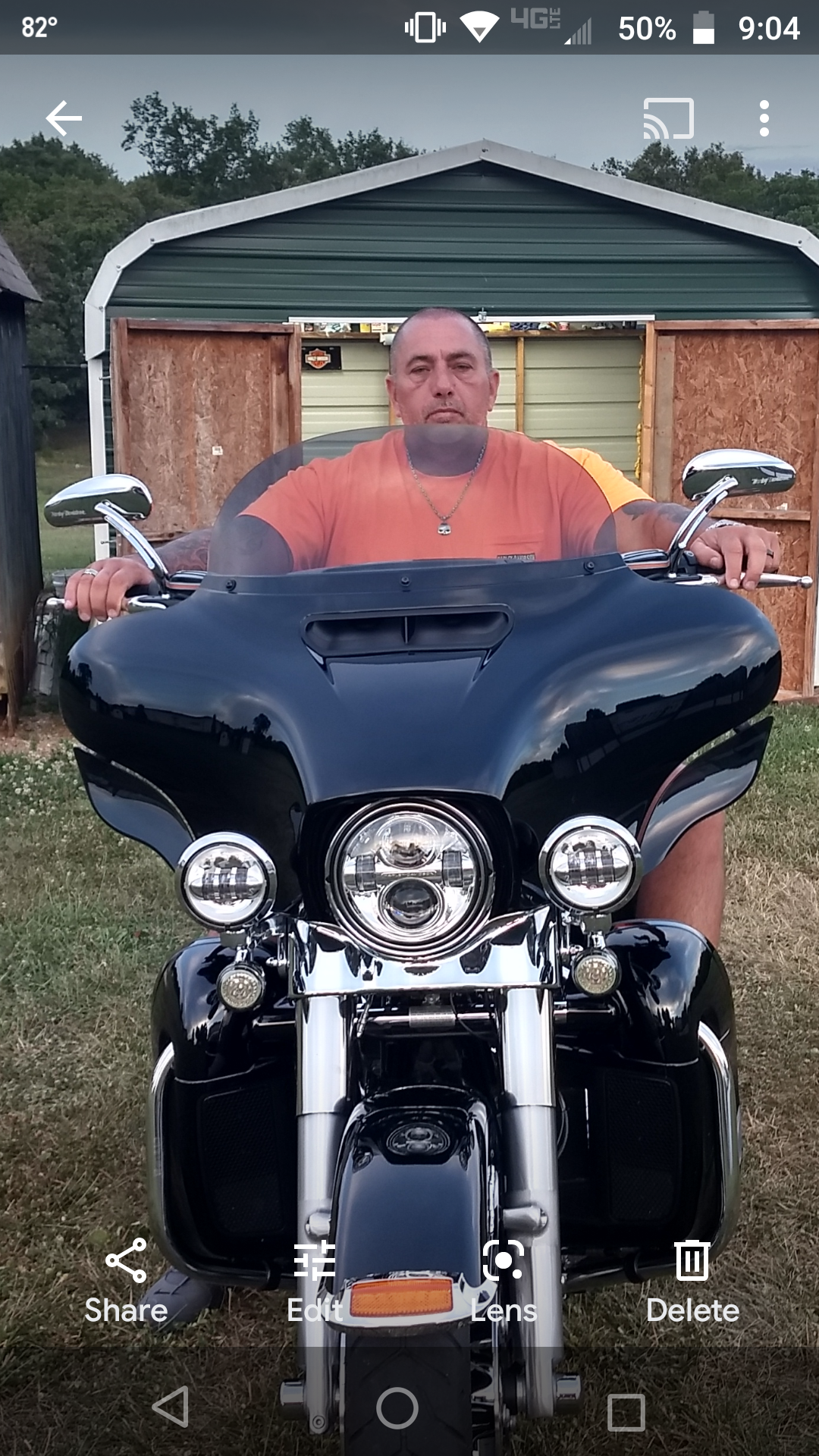

depends on what brand, i put 10 inch fatbaggers on my 2018 limited and my hands are over the top of the fairing just a little, all wiring is internal no problem on that. im 6'2 and you can see where my hands are.

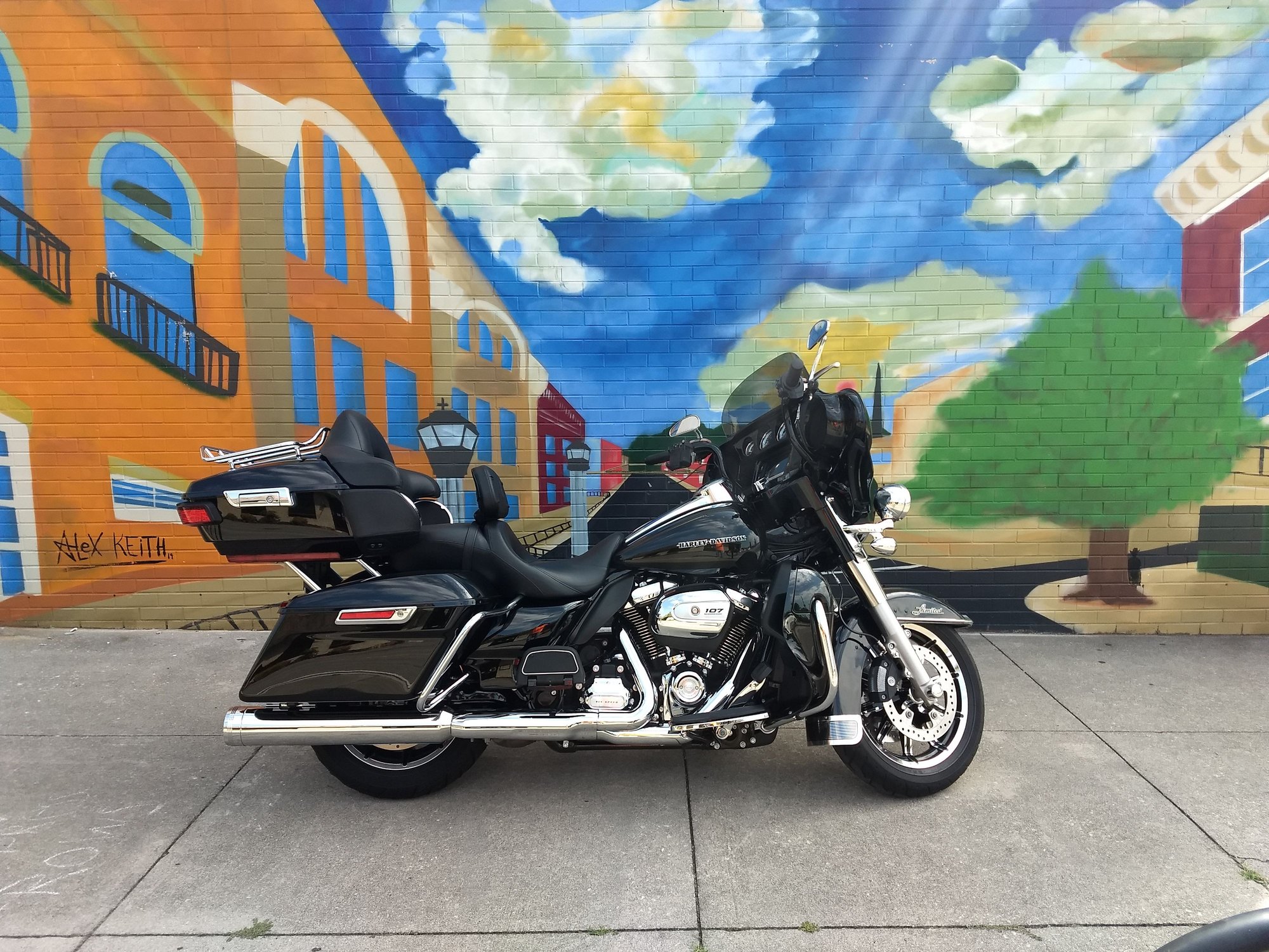

side view
