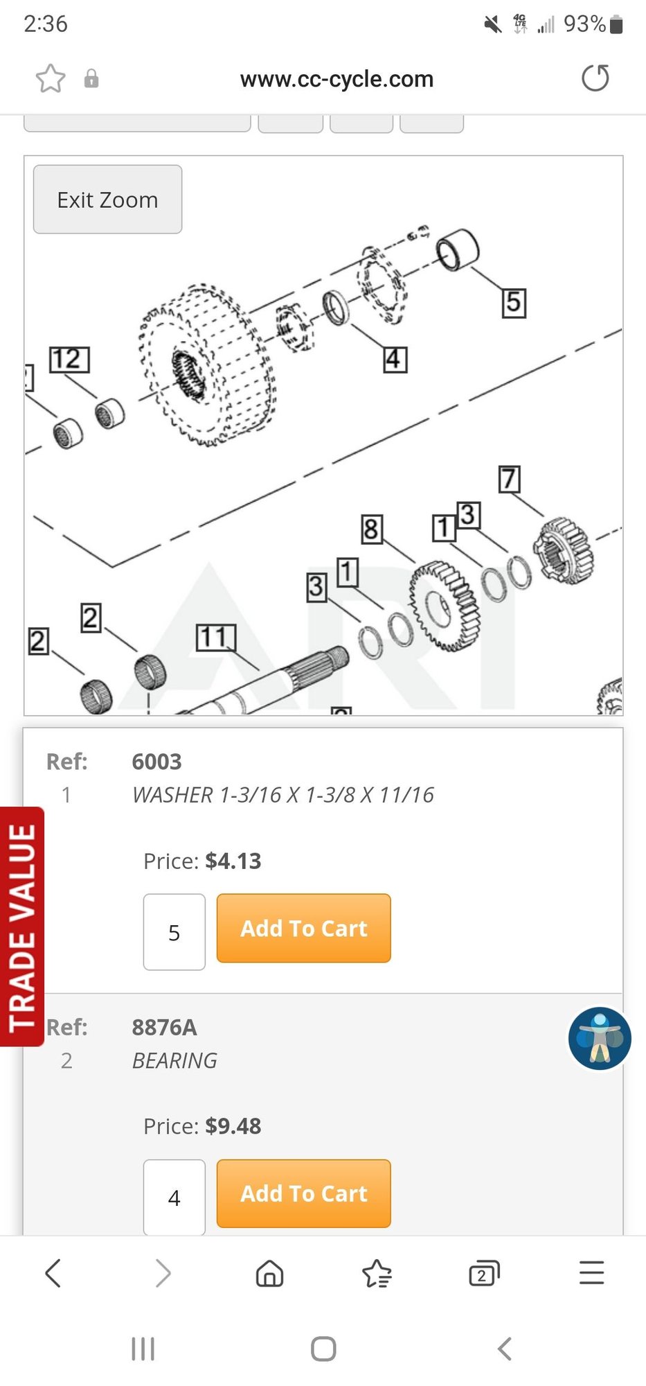

Originally Posted by clevelandpat1960
Good morning. I am sure everyone has talked about this before. I replaced the drive belt on my 2001 Road King. Cleaned everything prestine installed all new seals correctly. I filled primary with adequate fluid and it drips before the next day. Not the cover gasket. It is coming from rear seal. After dismantling second time I noticed the seal did not fit in the rear cover really snug. I was able to push out by hand. Also, sliding the seal over the shaft/race did not seem really tight as well. Any suggestions? All help greatly appreciated. Thanks.
could it be the little seal on the main shaft of the transmission? #4 in the picture
Old May 26, 2022 | 04:19 PM
clevelandpat1960's Avatar
clevelandpat1960
Joined: Apr 2022
Posts: 45
Default Seal.
Is that behind the nut? Where would oil come from?
