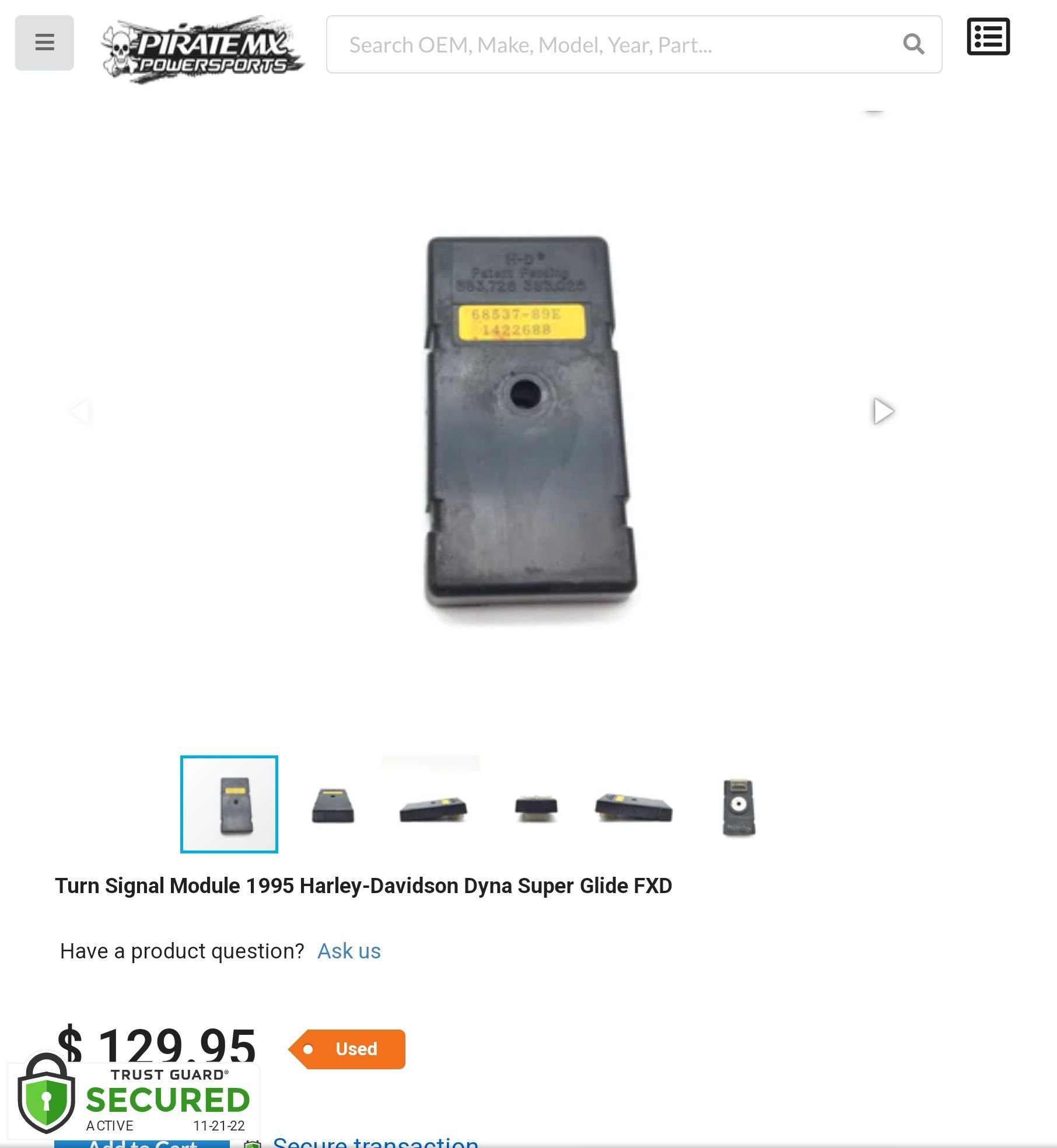

Default is this really it? I found it under the front fairing b above the headlight
if this is it its in the way wrong spot. this thing is located under my batwing. quasi im thinking i have multiple wiring harnesess here. bike is a road glide but has the street/electra glide front fairing and im noticing v this thing has more wiring than a damn conversion van.... it appears to have the roadglide harnesscplus an electra glide harness
