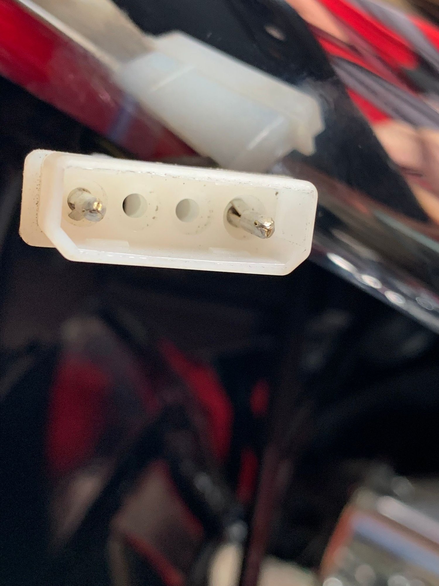

2017 Road king. Does anyone where find to find a connection that would work? The connection is behind the headlight on the right side. Thanks Hippie

IDE Molex connector. Any computer store in your town should have one.
You can buy this:
https://www.amazon.com/Aiyide-Computer-Molex-Supply-Extension/dp/B07DMTT8G5/ref=sr_1_3?crid=58IUIGCFPXWA&keywords=ide+molex+cable+extender&qid=1680280067&sprefix=ide+molex%2Caps%2C110&sr=8-3 https://www.amazon.com/Aiyide-Computer-Molex-Supply-Extension/dp/B07DMTT8G5/ref=sr_1_3?crid=58IUIGCFPXWA&keywords=ide+molex+cable+extender&qid=1680280067&sprefix=ide+molex%2Caps%2C110&sr=8-3
or you can do a "Y" in case you need to run another accessory.
On my 22, I used the other side, it has a red/yellow but also a ground in the connector, worked like a charm!
