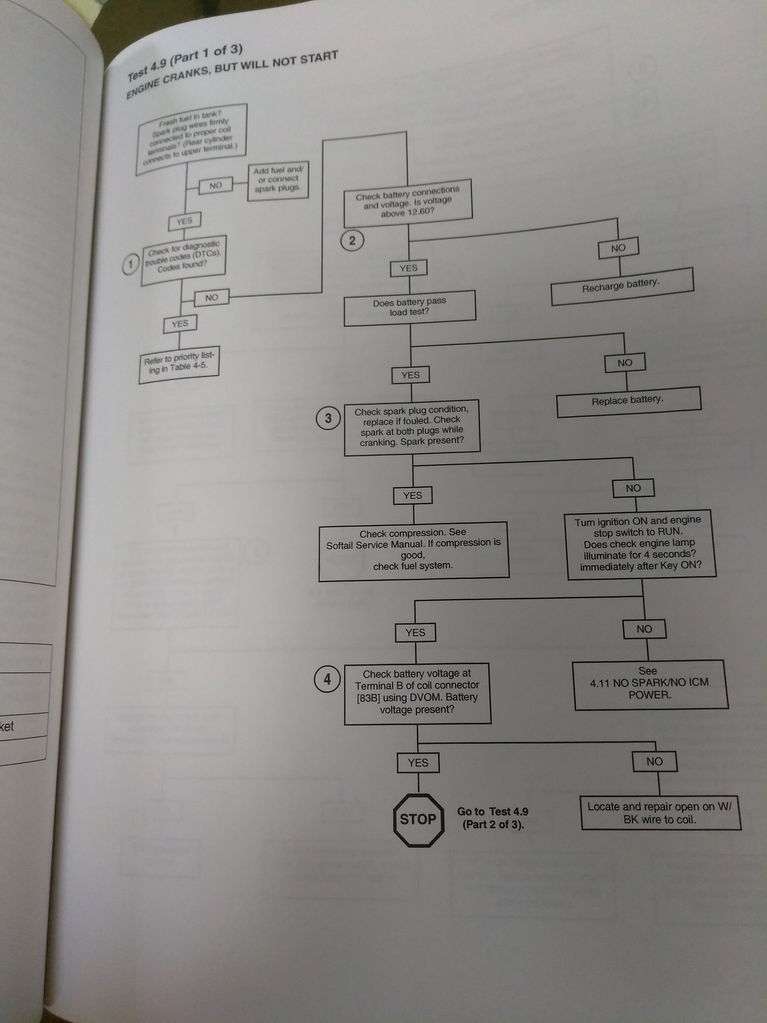

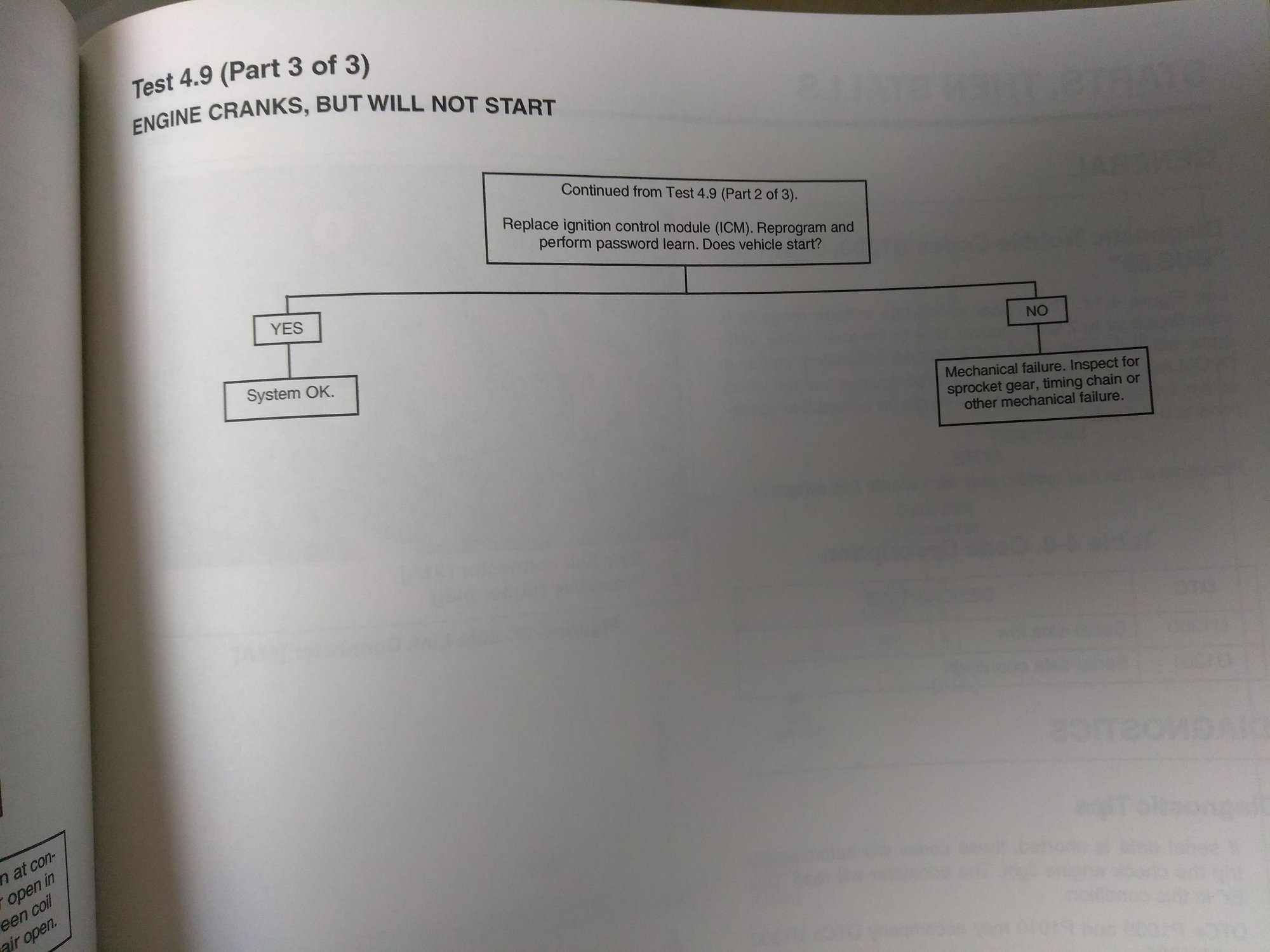

I assumed carburetor...
​​​​​​This for that...
